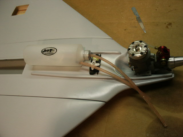

Next I cut the tank opening for the 8 oz Jett bubbless tank. Tank and line end up with interference with the throttle servo pocket. Oakdale OK'd my request to cut new servo pocket. Layout and cut the new pcket and find a former about 3/4" down . Hmmm a standard servo is going to stick up too haigh and hit the pipe! Reduce the pocket size and use a Hitec HS-81 miniservo. Grind a bit on the cowl rails to get the Dub Jett .60LX FIRE to sit nice and mock-up for the engine & pipe over the tank and servo. I will use a straight headder...A trip to the LHS .

Are you using the 8oz "standard" tank?
The 6oz "standard" is .75" shorter... do you think that one will fit without hitting the servo?

it is an 8 oz round tank from Jett Engineering. I was too long but I cut a new hole and stuck a Hitec HS-81 in place.

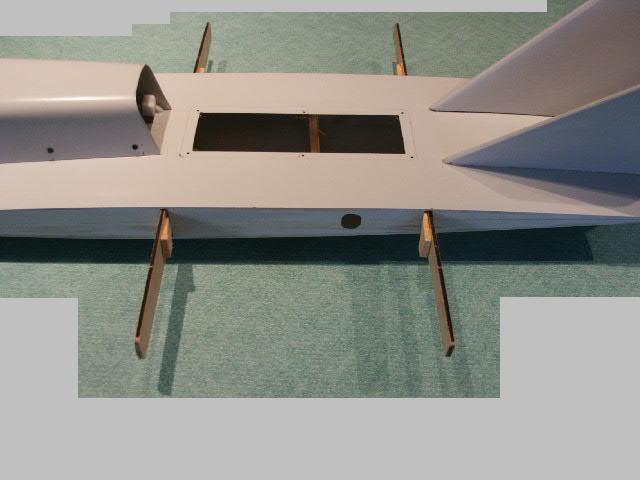

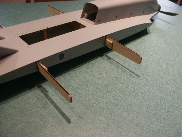

After testing the 30 minute epoxie, set time and full cure strength, the blades and pins were glued into place. Note that photo in manual has anti-rotation pin perpindicular to fin base. I put my pins in on the same angle as the plate and hook of the fin. Glue grooves were cut into the plywood plates both sides for added strength. Also I made up some 3/8 x 3/8 x 1/8 plywood squares & with medium Cya doubled the up the pads for the hatch mounting screws, needed no, but my personal choice.
Photo 1: The red crosshatching approximates what I did with the dremel and a 1/8" carbide ball nose burr.
Photo 2: Large red arrow shows the direction of the fin movement as it is being assembled. Red boxes to highlight changed from instructions.
Photo 3: Fins mounted but no glued yet all fitting will be done before gluing of final assembly.

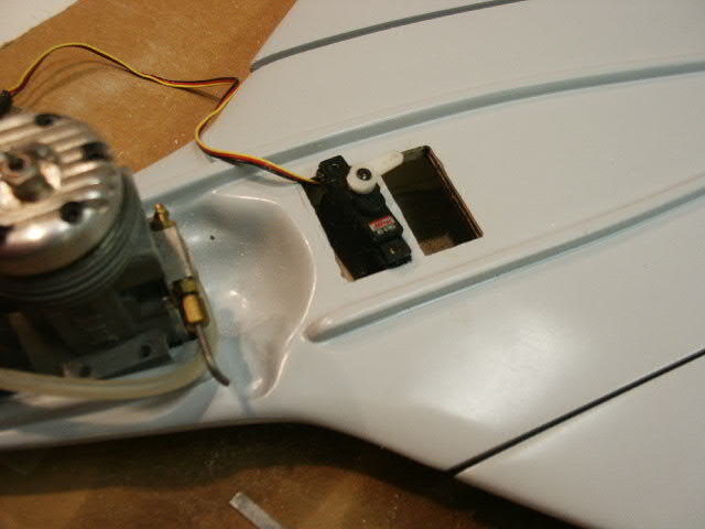

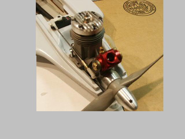

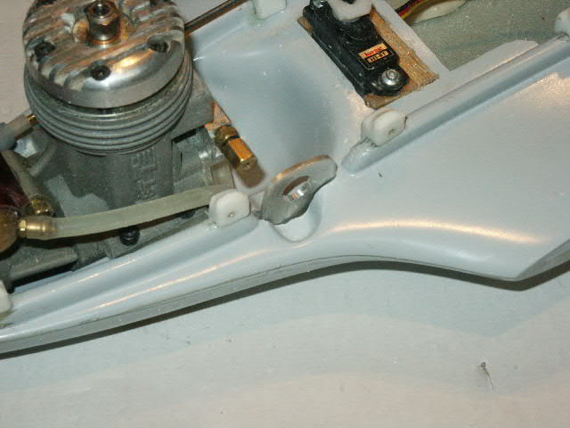

Started to mount the cowl, the throttle arm was not going to clear. So modify the arm and install a ball link. 2-56 rod used to decrease the mass of the throttle linkage for faster response.

Thats why the throttle arm is made out of soft steel. Bend, form and drill it as desired.
Of note, sometimes it works out better in some installations if you re-align or invert the arm so it runs over the "top" of the carb.

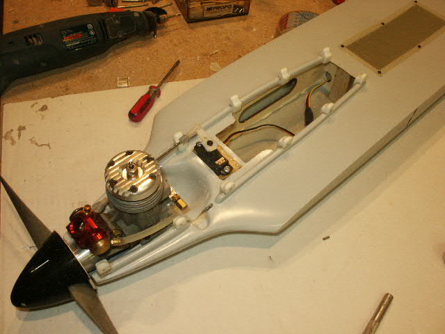

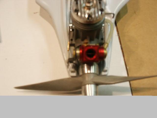

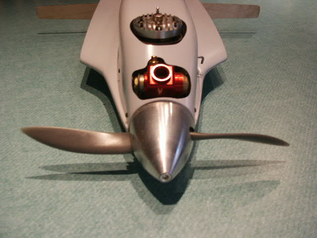

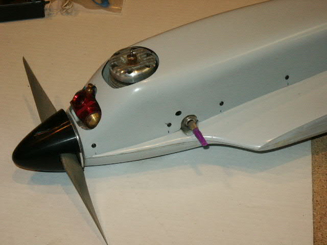

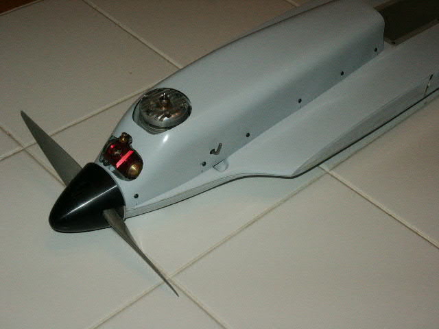

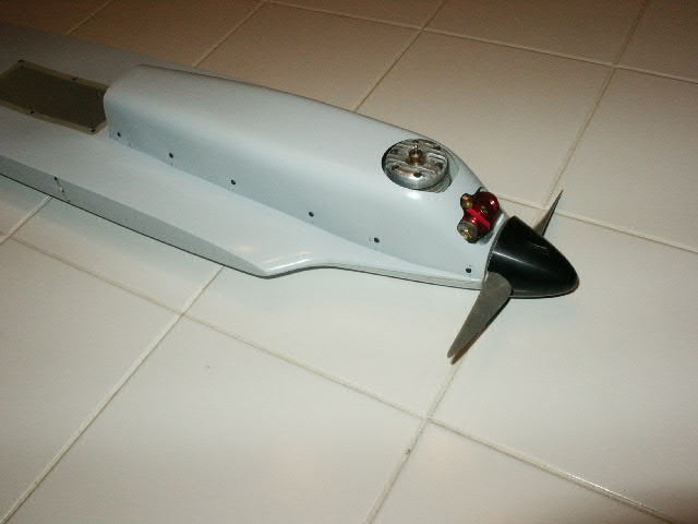

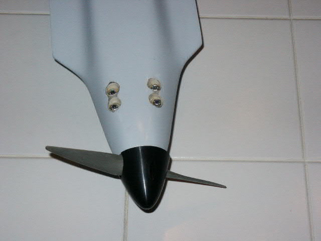

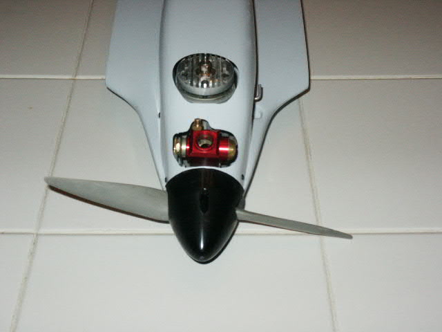

The Jett 60LX is mounted with 6-32 socket head cap screws.
Screw holes in the botton of the fuse were opened up to bout 1/2" diamater and cardboard tubes installed. This will keep dirt out of the fuse.
Cowl has been fitted and mounted.
Throttle ball link still hits inside of cowl at 3/4 + throttle, ajust ments needed.
Spinner is temporay. A Tru-Turn spinner will be installed before flight.

Nice, clean installation. How are you going to run the fuel lines?

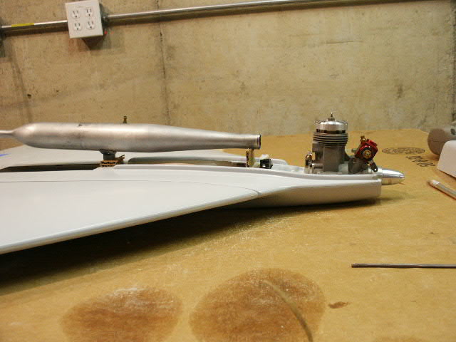

No problem with the throttle linkage just wire it wide open!!!!. Is the pipe going to clear the tank. I've got a DF BAE Hawk I'm working on as soon as that is done I will get the Phenom going. I need to call and order a 60LX but I was waitng to see how the pipe will fit yours is looking sweet can't wait to get to work on mine.

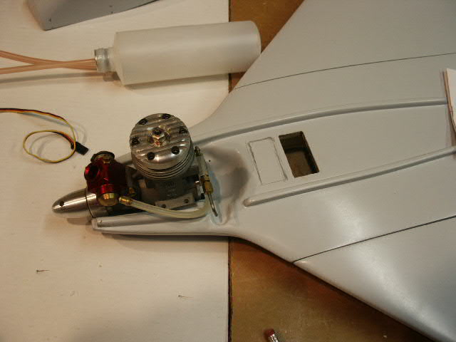

All fuel lines will be under the cowl. Fuel tank sits very low in fuse and the pipe will go over the top clearance is no problem.
For the pipe support, I epoxied a 3/8 x 3/4 balsa stock, cut to height, just in front of the former seperating the radio and fuel tank compartments. inside the fuse.
A Du-Bro fueler valve will be mounted behind and down a bit from the needle valve. See where the arrow is pointing about there. I have to make a bracket and cut the cowl. I did not care to snake fuel lines the the thin cowl because vibrations and the sharp edges would cut through the fuel lines.
Not picture are the mounting tabs for the cowl. I had to move some since the was an interference problems with the Jett 60LX.
A small grommet will be installed in the hole for the needle valve.

I thought I had pipe and headder but the one off my 50 fire Whiplash RIP was not useable. New stuff on order with Dub Jett.

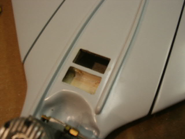

Cut a slot in the fuse for the quick fueler. Aluminum bracket made from salvaged landing gear. Thirty minute epoxy with milled glass fiber added to it for strength.
A standard nylon clevis replaced the ball link on the throttle arm of the carb to correct interference problem.

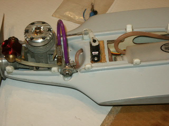

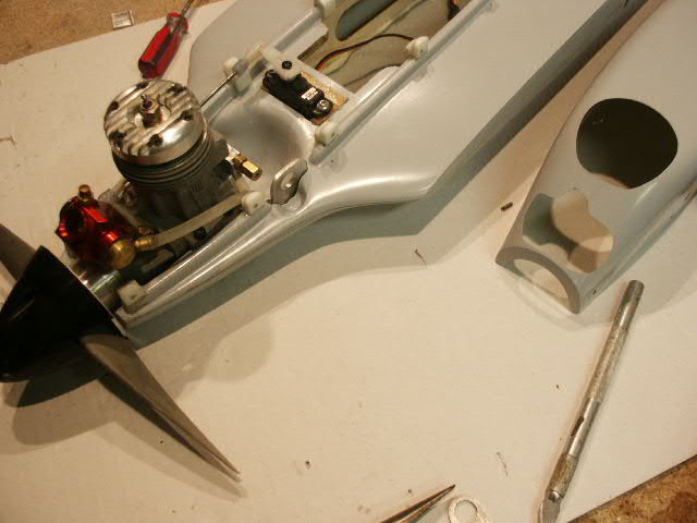

After the epoxy set, I notched the cowl.
Fuel line runs inside the fuse.
Also supports added to the radio bay's center area.

That is looking sweet, I have never tried a Dubro fueler valve with a Jett tank, my initial reaction was it could be an issue with evacuating the tank but after thinking about it should work fine. I wish I had thought about that on some other planes, fuel lines always seem to be an issue.

The purple fuel line loop is left long until the headder and pipe arrive.
Glued in the carbon fiber horns into the elevons. Milled glass fiber added to 30 min epoxie. Additional glue dimples put into the horns.

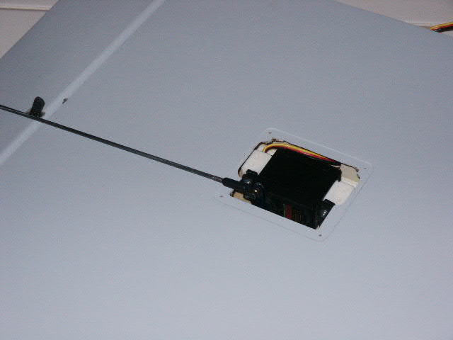

Servos are mounted into the wings.
Hatches drilled and servo arm slots cut.
4-40 pushrods made and silver soldered.
Servos used Hitec: HS-5645 MG Digitals with aluminum arm.
I added 1/16 ply to inside of the wing where the servo mounted
For added wing strength and to raise the servo, no picture.

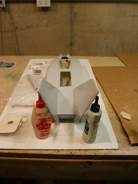

Today I go the fins fitted and glued down with 30 min epoxy and milled glass fibre.
Next I fitted the spars, sanded off 1/16" per end and put radii on the corners.
Glue them in with 30 min epoxy. The are held in place against the fuse formers with a servo screw in the center and wedges in the slots that the spars fit through. The last picture has a red circle showing the screw I added to hold the spar up tight to the former. The screw was installed prior to assemble in the test-fit process.
A 2" True-Turn spinner was installed matches the cowl diameter dead on.
