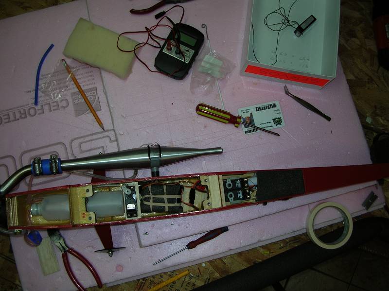

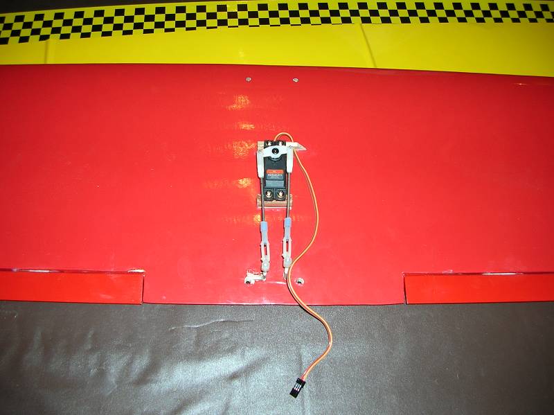

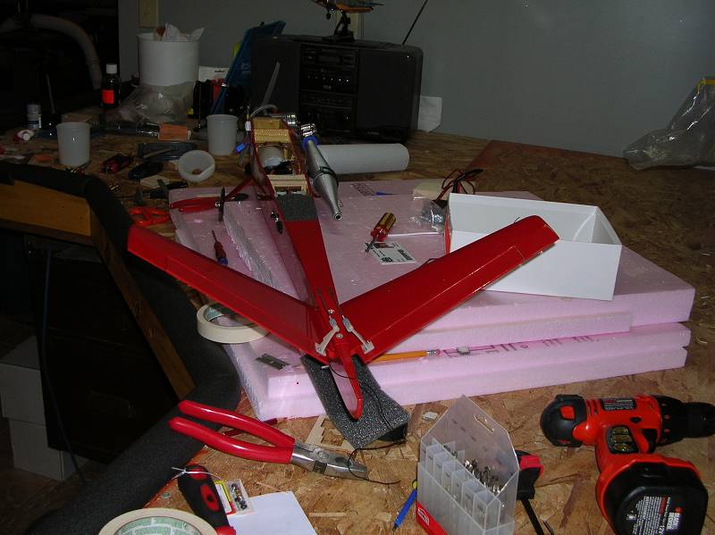

WEll im part way done the viper and took a few pics take a look a let me know if you can see anythign i may have forgotton i know the throtal servo isnt hooked up to the servo arm and that i havnt put the peice of fuel tubing on the clevis's

Its coming along nicely
A few items I see here.... if I may......
get rid of the screw-type hose clamps.
they will eventually cut through the coupler (works like a cheese slicer). And they are heavy. The coupler is not a structural attachment between header and pipe ---- the pipe mount takes care of that.
Just use a 1/8" wide nylon tie wrap on each end of the coupler. Pull them tight. This is mainly to keep the pipe or header from moving around inside of the coupler, and to provide a gas seal so it does not leak.
Glue on the forward tank hatch. You can slide the tank in and out through the wing bulkhead if needed later. Add some 1/4" triangle stock to the upper edges of the fuselage and top side of the firewall, and glue the hatch securely around all four edges. You need the stiffness on the front end with that engine. (of course, remove covering from the suitable glue surfaces)
Very important the the RX be well packed in foam, and does not physically touch the airframe. Looks rather snug back there... perhaps install it up in the main compartment under the wing?
One other item.... seal the aileron hinge gaps (not optional in this case). You may want to seal the elevator gaps too. Use iron on covering, blenderm tape, or even just heavy transparent "scotch tape" works fine. Deflect the surface full up, tuck the seal tape down in the gap.... and afix to the flying surface and control surface.
Bob

we had nylon tie wrap on it but found that it would not hold it it was just spitting oil out of both sids the coupler maybe i will give them a try on the plane.........

Thank you for reminding me about the hing tape umm as far as the tank i was goign to screw it down to the firwall (i added a 1/2" piece of ply wood to help strengthen the firewall and add another peice of wood at the back to screw the hatch down and silicon the front to insure that wind does not get under the leading endge of the plate i the reciever i will double check but i think im fine its a very then rx (jr R600)

the coupler should be tight on its own.... the ties are just to prevent any coupler motion during engine run. It is that motion that tends to cause leaks.
Make sure the aft pipe mount is solid... the pipe can not move.
This is all that is required on the header (see photo)

its not the firewall... the entire front end of the plane will twist in flight. Gluing the hatch on will get rid of that issue... creates a full box structure right up to the wing saddle.

Bob is 100% correct, glue the tank cover down! Also, don't slam a spinning electric starter on to the motor, is the starter cone well centered? If your starter motor is too weak, turn the prop off compression(watch your fingers,use the spinner) than trigger the starter's switch. Try to spin it a few times with no power to the glow plug. Make sure it's not hydro locked. If not, get a bigger starter.

I must really be behind the times. Three different dual rates, all with there own expo setting? I have never owned an electric starter and plan to continue using my wood handle screw driver. I crank my fuel by hand too.
I totally agree that a fuel tank hatch can cause some twisting and can rob power. However, on my sport Q-500 Blackjack II (SJ 50) I do have a hatch that starts about 3/4" back from the firewall. It has simplified my life a couple of times with over 100 flights on it. If I was not competitive racing I would do it again.

I agree with Bob, the rigidity of the nose of a plane has an impact on top speed. Gluing things solid DOES make a difference. The avereage speed flyer may not notice the difference, but a 1/10 of a second here and there make a huge difference to the racers.

I't wasn't so much the speed I was thinking about, it was keeping the firewall on the plane[X(] I know of two planes that lost the engines in flight (one landed with the engine dangling by the throttle cable), they had screwed down fuel compartment hatches.

Besides the power loss due to the flexing of the nose, gluing the hatch will give you one more edge glued to help keep the firewall in..
