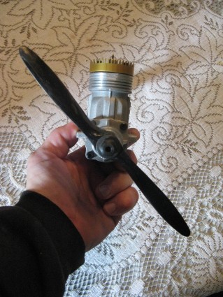

On another note, I got my speed props. Somehow this picture just doesn't look normal, in terms of the relative amount of space each one takes in the photo.. This is an 8.25x10. Steve Wilk says the D speed guys are running 25-28k on these but need to trim them down to keep the rpm up with AMA 10% speed fuel. Might be a hair light, but my engine is bone stock, has a carb (a big carb but a carb), and I'll be running FAI fuel. So I am not convinced it is too small. Does someone jug that stuff I wonder - 70/20/10 methanol/nitromethane/castor?
I'm still worried about the sanity of this whole venture, but I take that as a sign to forge ahead.
One of my sincere concerns is which one of my buddies I can talk into hand launching it. They already wince at .50's. Although.. the engine is a bit in your face with these ain't it?

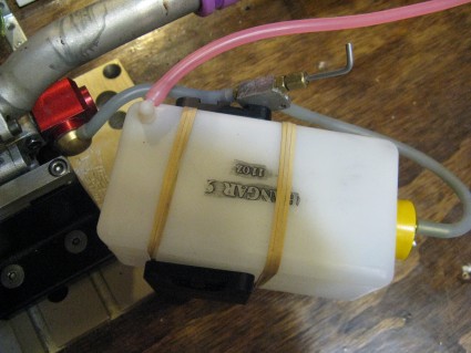

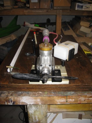

Fitting the engine up to the test stand, plumbing, and not finished the pipe support yet (but I am now).
Also a chance to give the converted tank a go as well. It is leak tested and fuel goes in and comes out the same hole, so dunno what else to be concerened about.
So.. is medium i.e. standard fuel tubing really enough with an engine that eats 3-4 oz a minute?
I'm skeert.. [sm=devious.gif]
MJD

Looks good. Is that the recommended pipe for it? Looks smallish with a lonish header...
Old 09-30-2009 | 09:15 AM
  #49
MJD's Avatar
MJD
Joined: May 2003
Posts: 8,658
From: Orangeville, ON, CANADA
Default RE: Screaming Demon big block bash
ORIGINAL: evan-RCU
That is a MACs 1160, and it does look small doesn't it. The header is a bit too long, I will bring the plug-fat bit length to 12" for starters. Just setting stuff up here.
Hmm.. with an 8.25x10 prop I need to trim this down to 7" for break-in according to the rules of break-in by ILJ. That skeers me even more.
