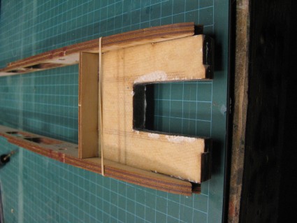

This is not official build here, as in laser cut prototype parts and all that. This is a good ol' bash-it-on-the-bench build, mostly because I have more than one idea about nearly everything I need to tweak. So this works better than staring at a monitor.. and more fun.
I am sticking with the wing size, and kludging together a structure around the tank area to make up for lost integrity in that area. Also, I have doubled up the front half of the center ribs, and have added a pair of spars just behind the carb inlet which will tie in to the LE, and whatever else comes as I go. I am pretty sure I can keep it under 4 pounds. I'll extend the rear spar right through the tip to the vertical fins to tie it all together. And I might use something more substantial than 1/8" balsa for the tip fins too..
The LE sheeting will extend further back, and will be supported with sub spars and webs to preserve the airfoil shape a bit better. I'll be using Ceconite fabric covering again, and it stretches so tight it nearly flattens the sheeting without help.
I have a pair of CF "D" speed props coming, I'll get those on the engine and on the test stand when they arrive.
If this holds together, and if I do, it could be my ticket to 200. And it is a small enough project I'll get it done in this lifetime too, that helps. Maybe even this fall, but I'm learning not to make optimistic claims.

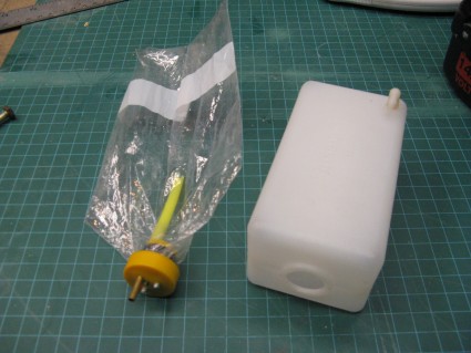

Oh I forgot. Pictured is my conversion of a Hangar 9 11 ounce clunk tank to a bladder tank. I heat sealed a moderately heavy walled poly bag in to a tapered neck shape, added a pressure inlet to the rear of the tank, sealed in the bladder and pickup, and voila. Comnpletely sealed tight. Now I have a bubble-free tank that allows the pipe to sit flatter and just gives more room - here, a cylindrical tank is a disadvantage, so I'll use the Jett 12 oz in something else.

Great work, Didn't know you could make your own bubbless tank too. I never tried one, Just need to understand the heat shrink process.

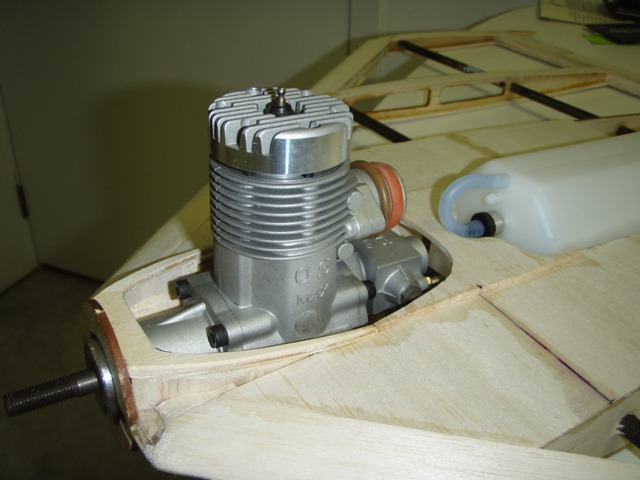

Here is my contribution to the 'big block' developments. We shall see how I'm going to fit a reciever, rx battery and throttle servo all in that little space behind the fuel tank.
Enjoy,
Tom

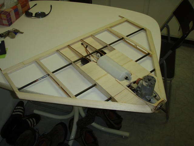

Is there something wrong with RCU's picture uploader?
Enjoy,
Tom
4 cell flat packs fit fine in the rear bays. Mine is in the left rear to help offset side exhaust engines.
MJD

Yeah, the next issue I had to figure out was the needle valve since it would end up inside the wing.. Thought about it for hours and then finally the light came on. I simply made a plug for the hole and will just use a remote valve mounted somewhere else. You probably have the same thing with the OPS?

Yeah, on the .65 with the Jett .90 carb it needs a remote needle. I plan to fit a Perry remote NV to mine so I can twiddle it in flight which is generally recommended for running these things balls to the wall on an open pipe for RC speed. Once I think I can fly it and it still exists, I may switch to a venturi and pressure (and RNV).

The C/L Speed planes and what I've seen of some of the SpeedCup planes use form fit tanks...somehow they control foaming without baggies? Or they have figured out how to make form fit baggies to fit those custom fit tanks? There hasn't been much talk about this detail that I'm aware of.
Old 09-22-2009 | 06:27 PM
My Feedback: (44)
Joined: Feb 2008
Posts: 896
From: kuna, ID
Default RE: Screaming Demon big block bash
some use a type of foam from auto racing fuel cells, and most just soft mount the tank to the pan with RTV or goop, but they all are using case pressure.....

lol, back to the bladder issue, some use the baby bottle liners to make the bubbleless bladder tanks
