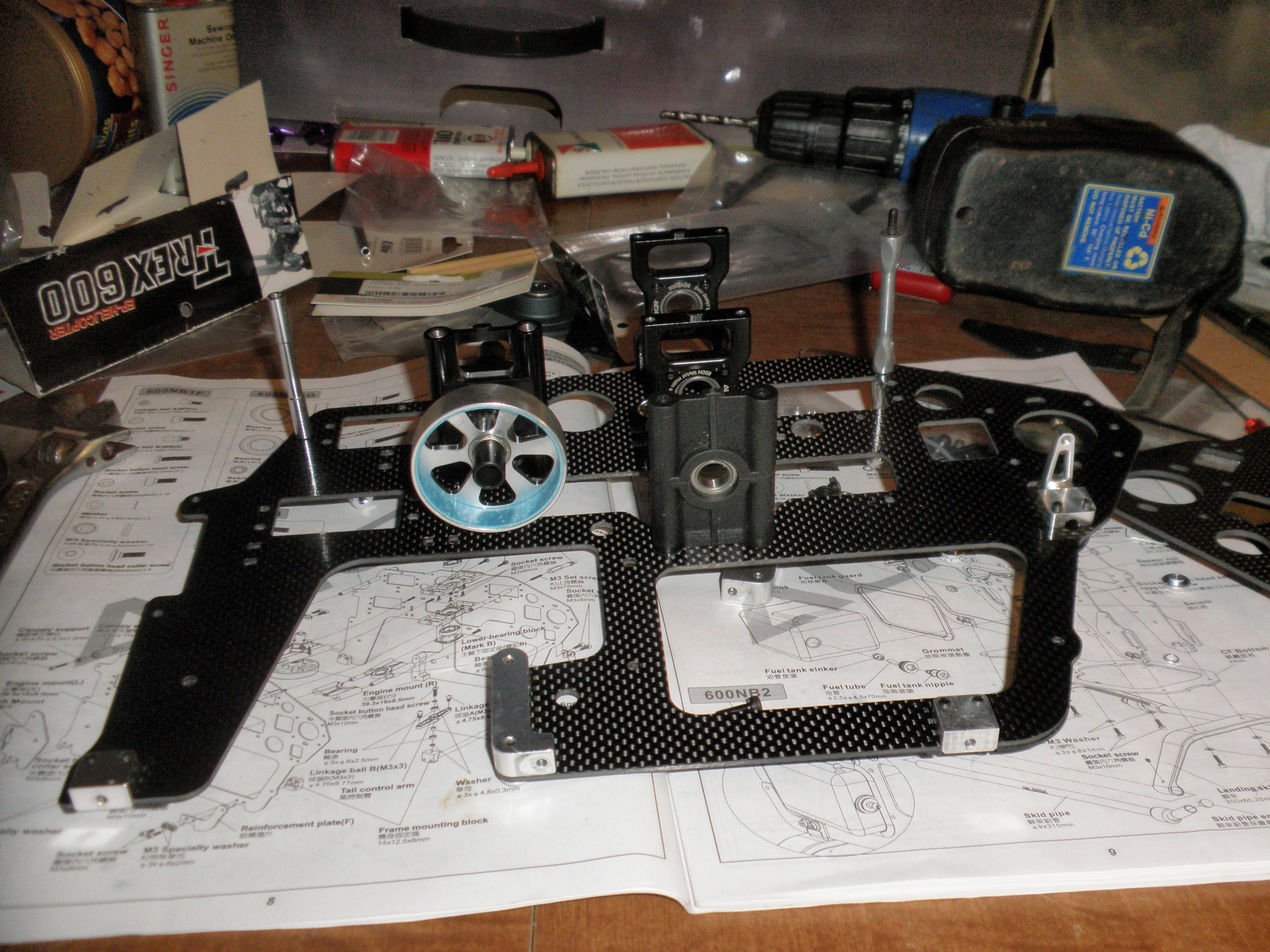

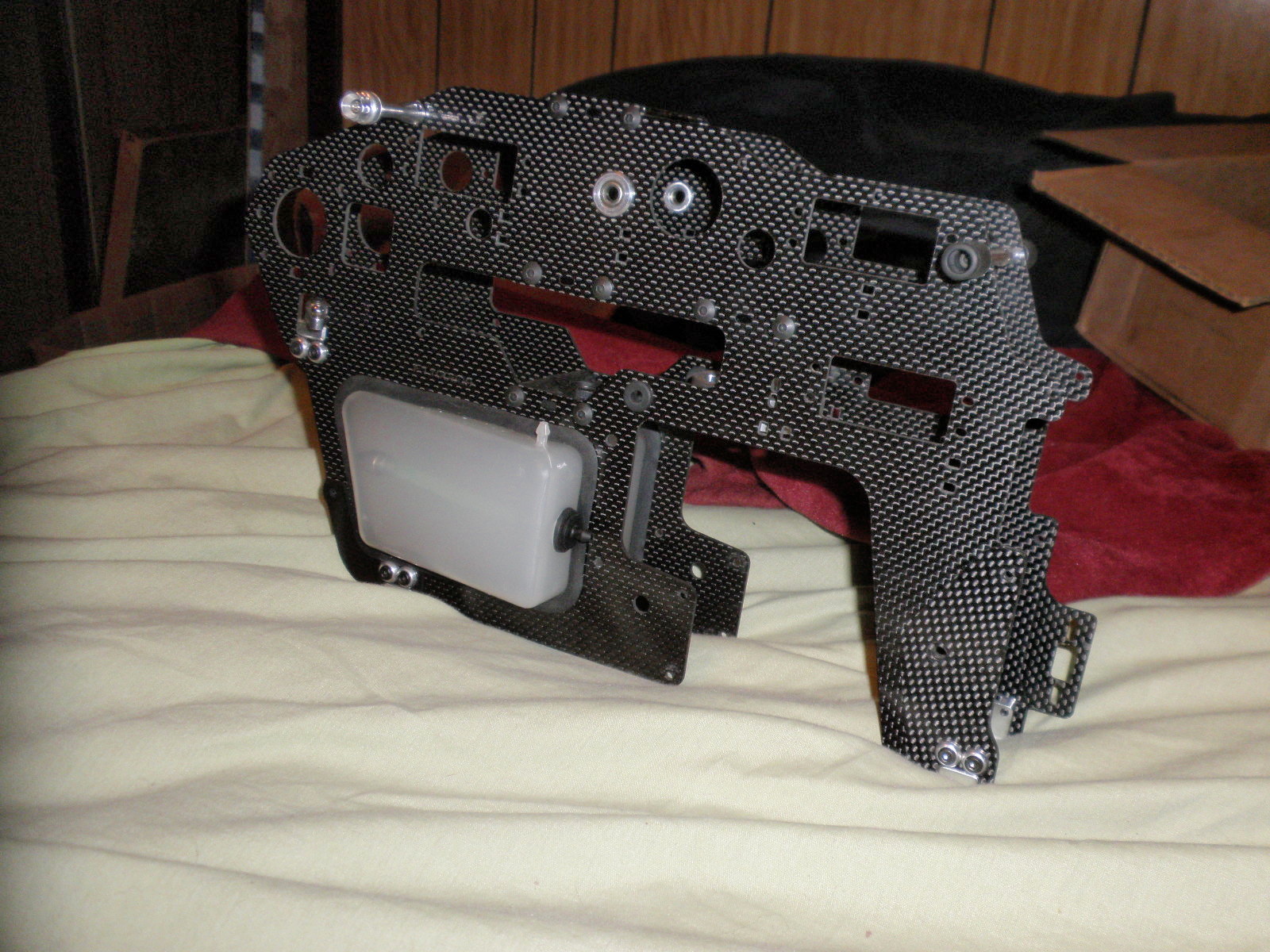

just bought this wrecked helicopter off ebay. they call it a t-rex 600N pro DFC i believe. i know how to fix and rebuild flybar helicopters. but this new flybarless helicopters are new to me. so i figure it would be good experience to figure out how to fix and rebuild the new ones as well and how they work.
1st thing i did was to purchase an assembly manual as a reference book if anything else. and this is the way i got it in the mail!
bought some new flybarless rotor head parts. took the main mast out of the package and put it in my lathe and spinned it up to make sure the new main mast was ok. which it was. wanted to make sure before hanging new parts on it. want to do it right the first time! so far got the new flybarless rotor head rebuilt thats far as i got.
next few steps will be to get some replacement parts for the clutch,main gear and get another frame for it once i get paid again. as the frame is cracked,pieces broken and few spots broken clear through. will post more pictures once i get time and money and parts to work on it more so stay tuned.

Looking at the second picture, it seems to me that you have already mastered the difference between a FBL and a FB helicopter. Everything else should be smooth sailing.....

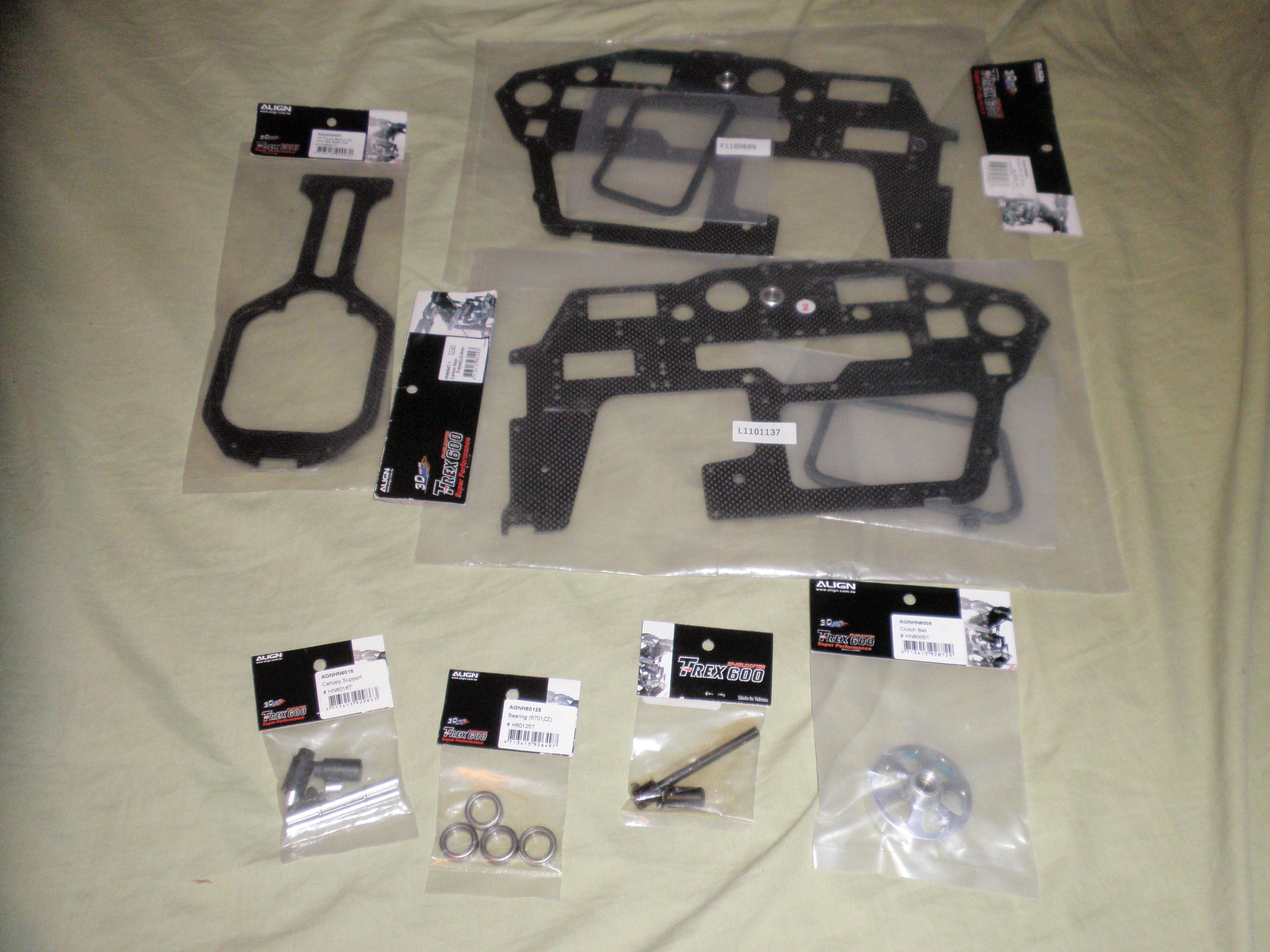

well the ups man visited me today. got some of my t-rex 600N parts and looks like the other half will be coming tomorrow.
then a coarse knucklehead me forgot to order the bottom block bearing. so that will be few days before i get that! just when you think you have everything you always seem to forget something lol. anyway i can least get started on the main frame till the bearing i forgot gets here.

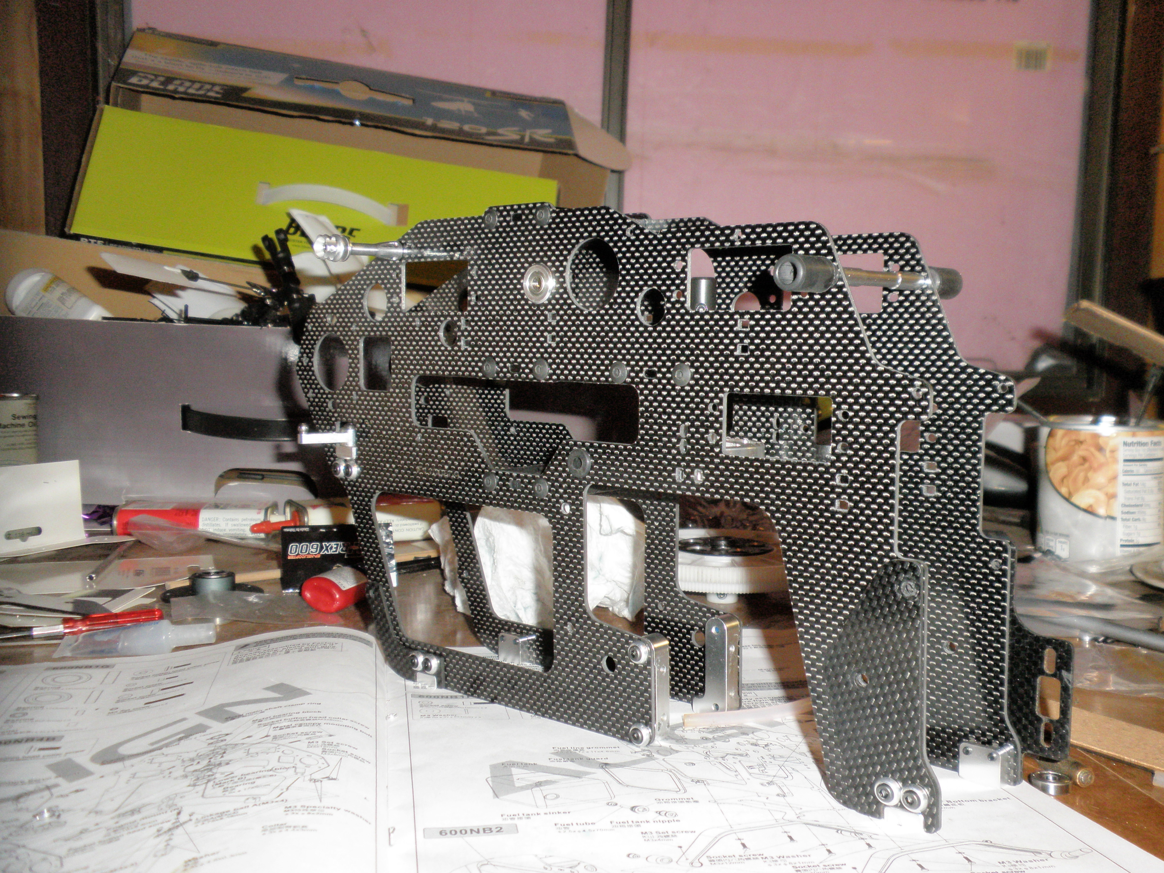

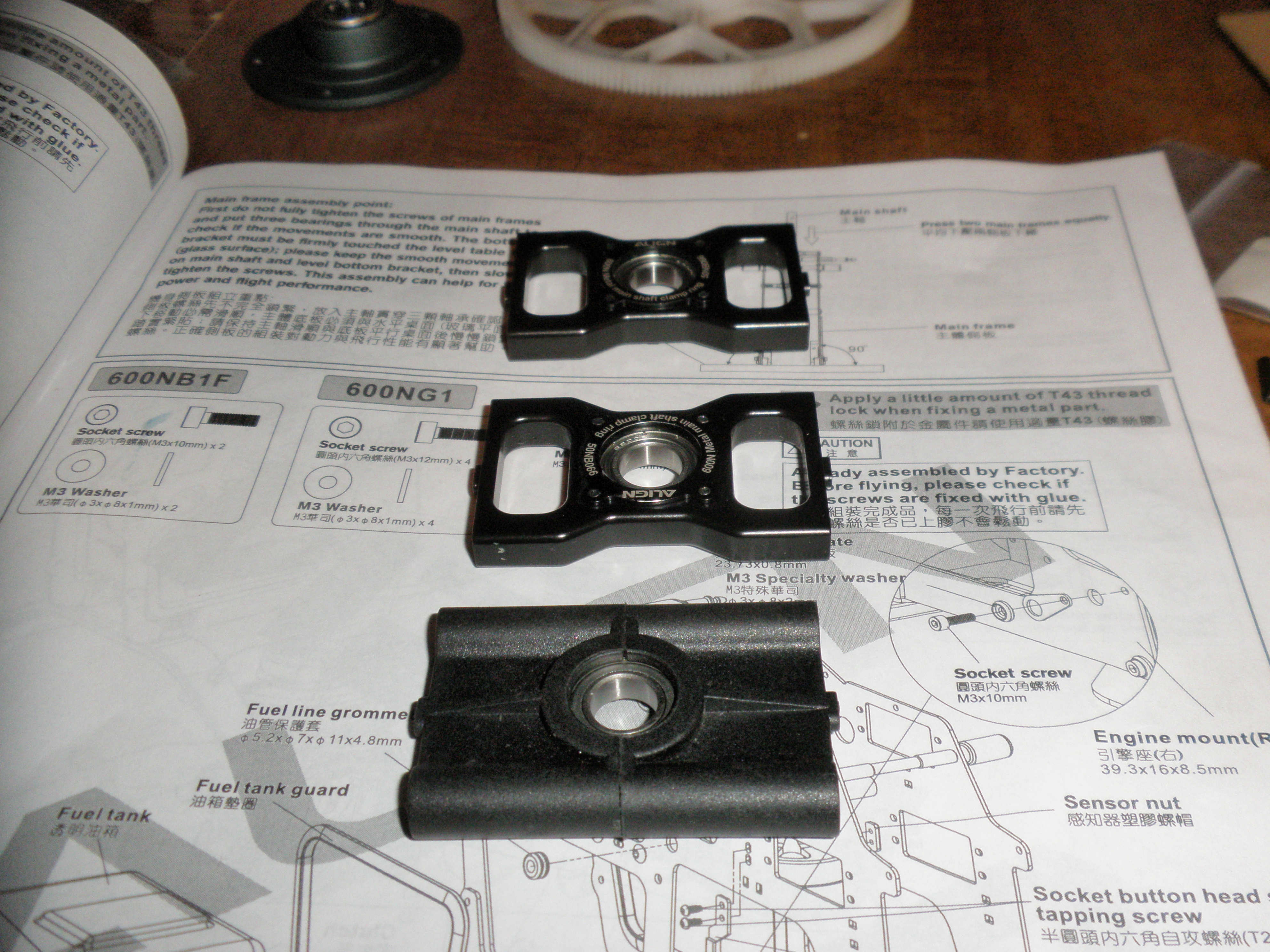

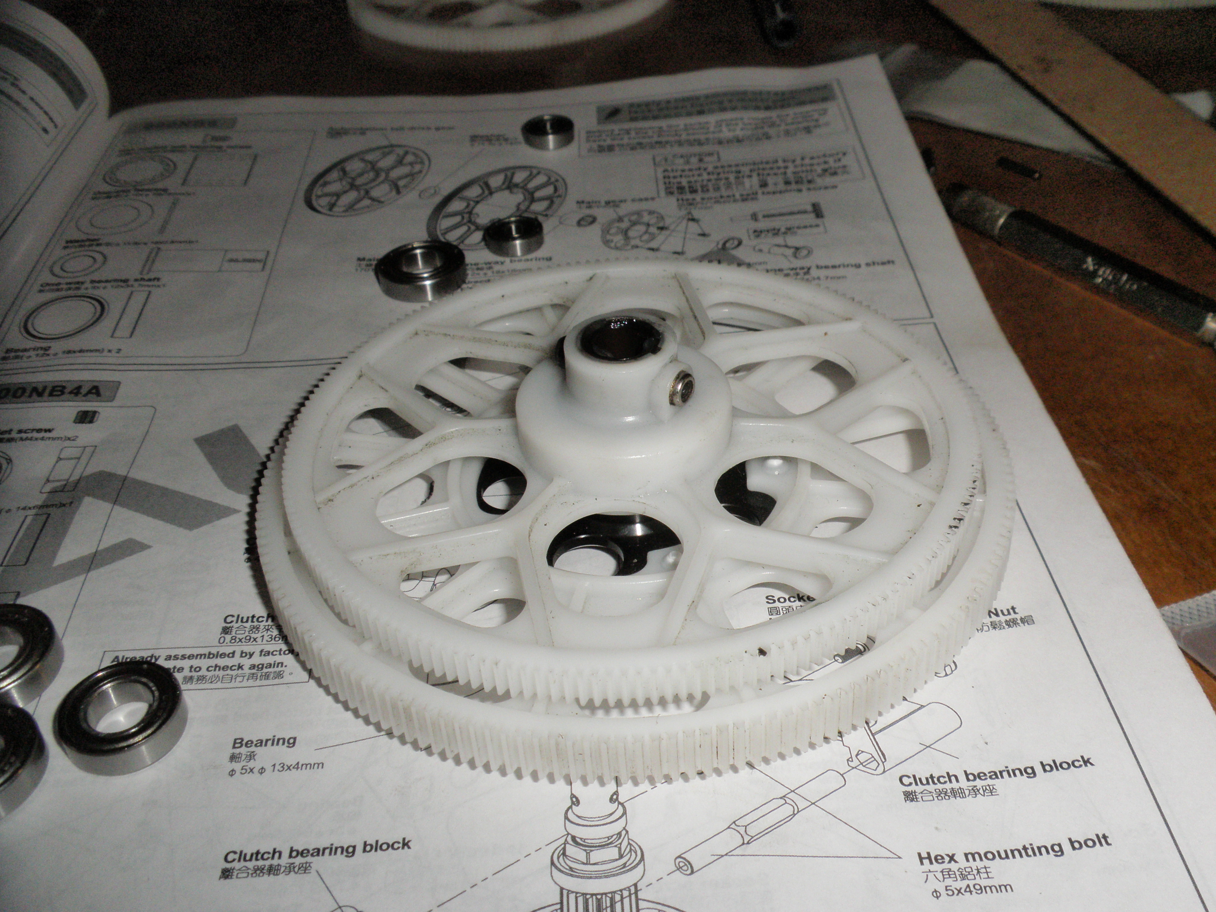

UPDATE: 5/09/14
well the ups man brought almost all of the rest of my parts today except the main shaft witch that should be coming any day now.
started the frame parts today! replaced the one-way bearing with a new kde one-way bearing and also the other bearing that go's on top of that, then greased the one-way bearing then put the shaft back in it. so now the main gear is done.
also replaced the 3 main rotor bearing blocks with new bearings!
then moved on to the clutch assembly. replaced with new bearings,then assemed the clutch or least the frame half on the clutch.
then i started to assemble the parts onto the frame. canopy mounts,bearing blocks,frame half on the clutch,tail rotor control pulley,landing skid mounting blocks,motor mount and installed new hardware to go along with it.
and this is what i have at this stage. rest will have to wait till i get some more money or wait till next month when i get paid again. will update the next stage when i can or able too. its now starting to take shape instead of a box full of piled parts lol. so far its been fun building my first flybarless helicopter!!
