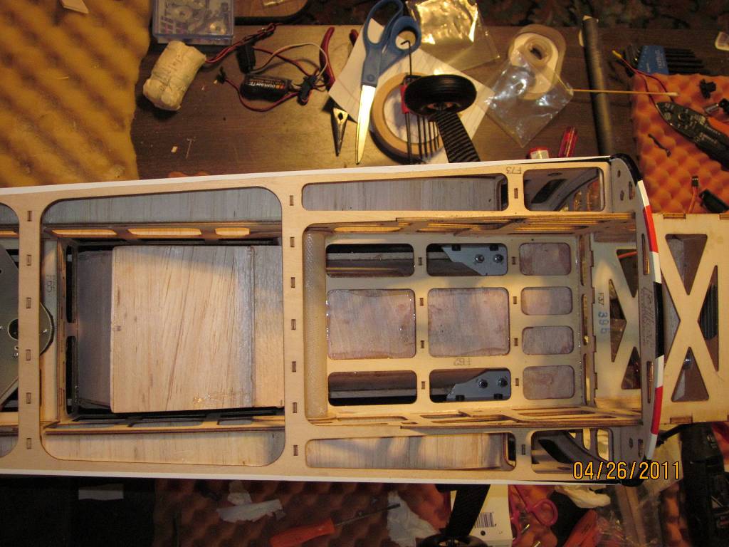

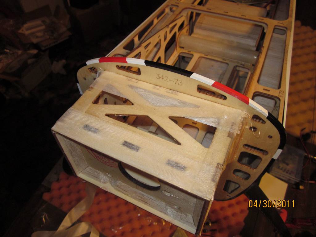

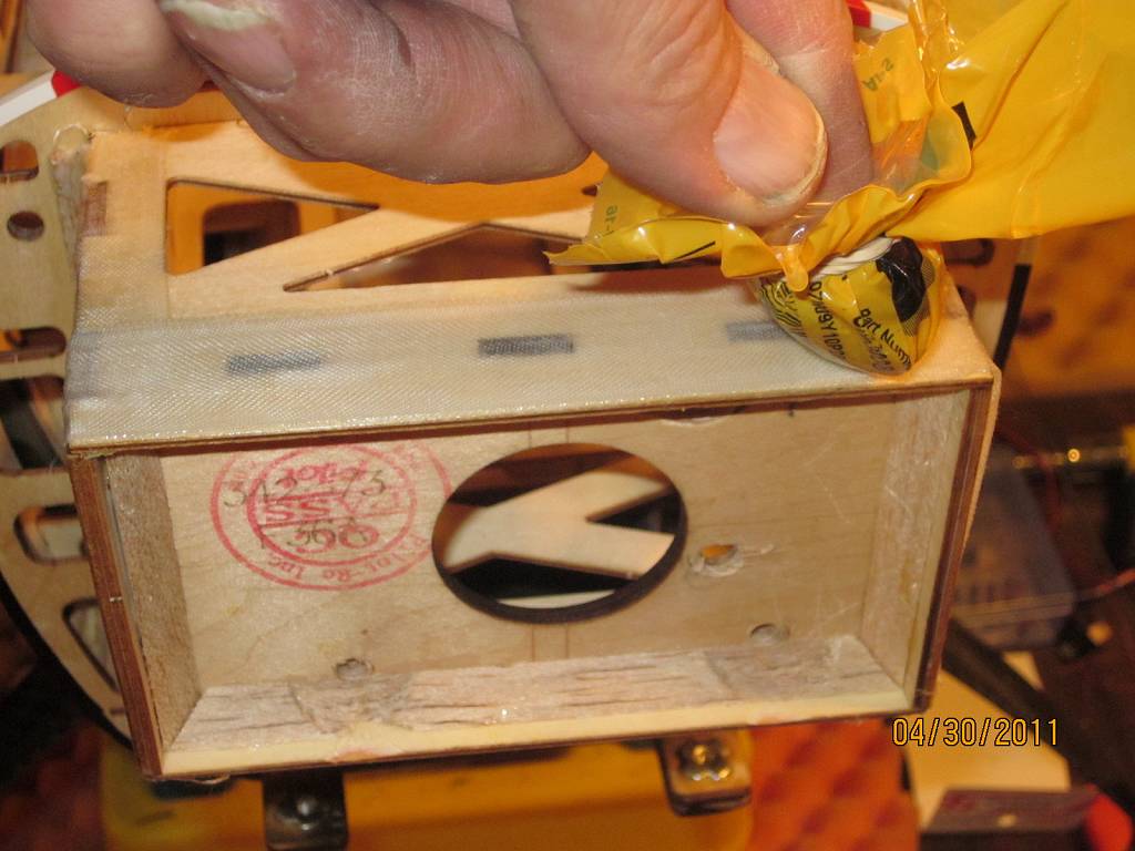

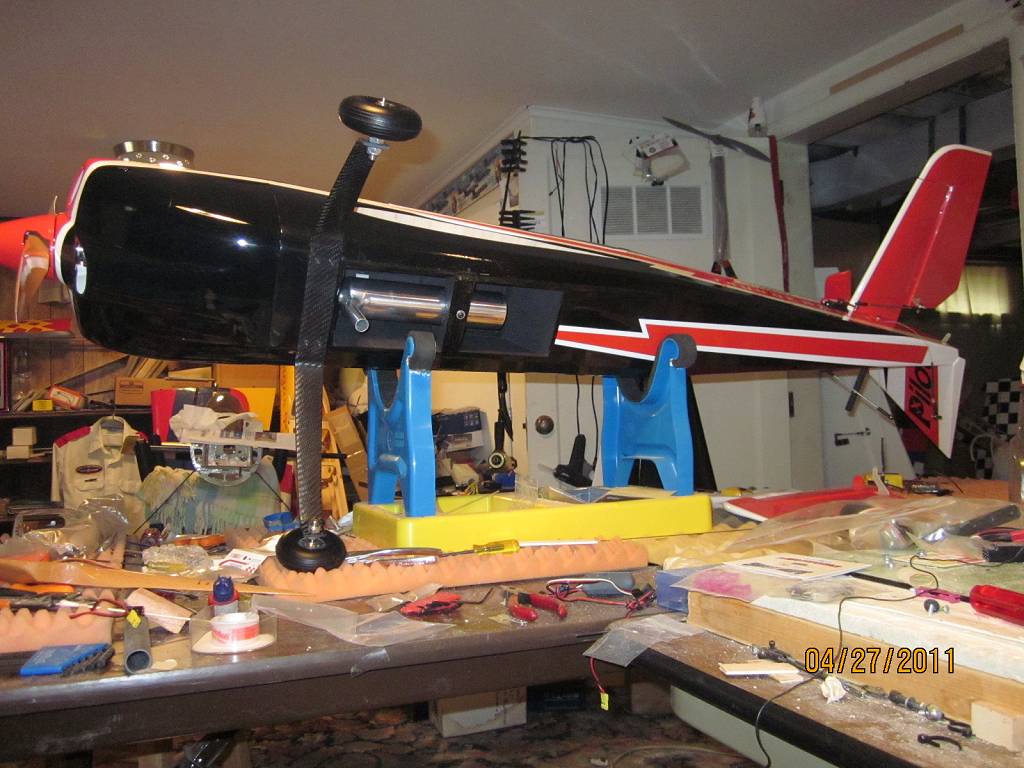

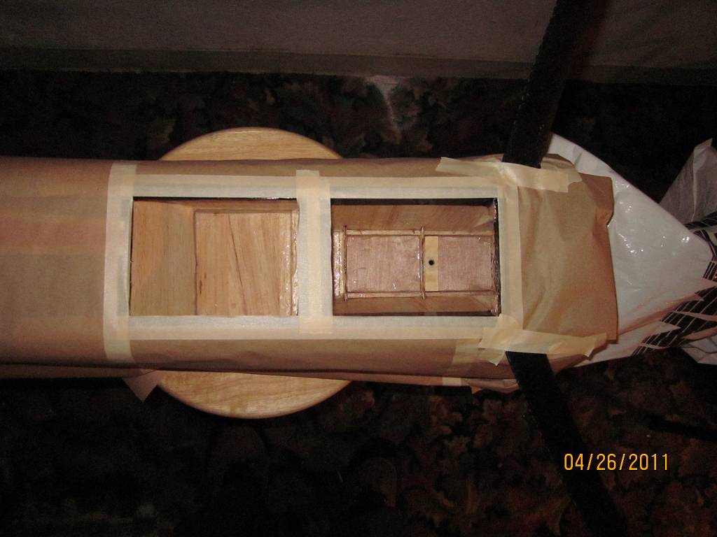

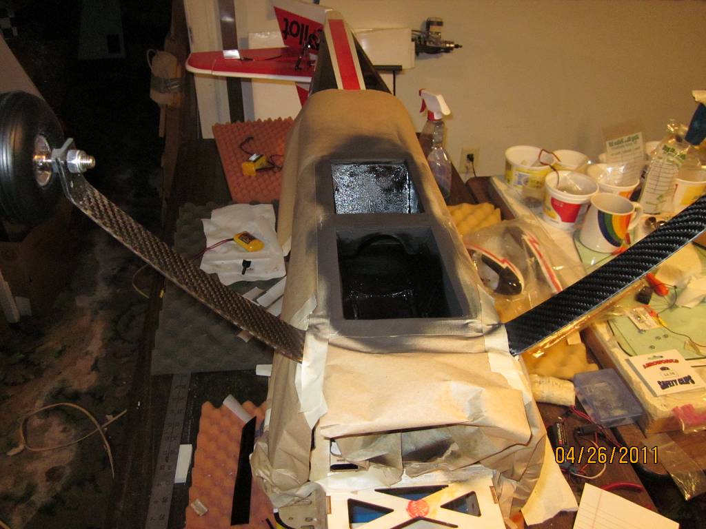

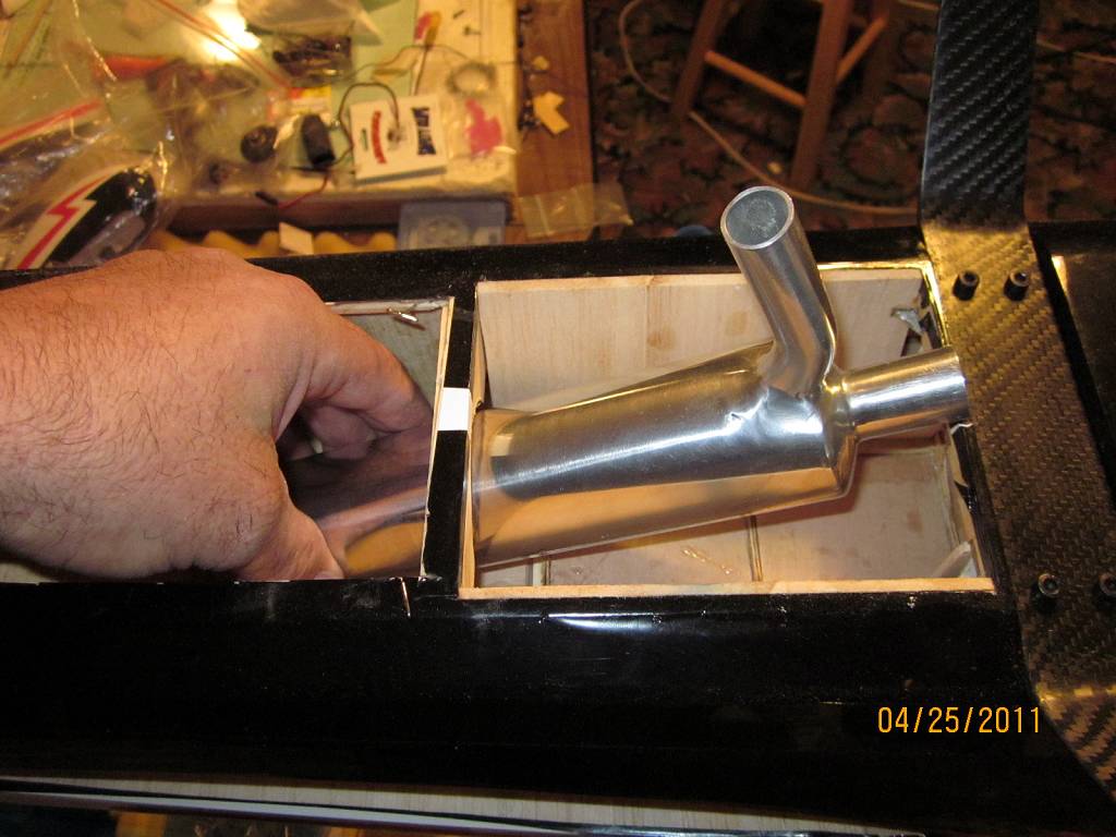

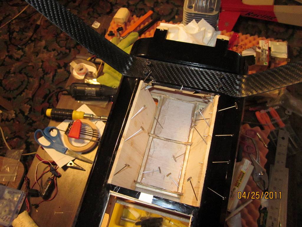

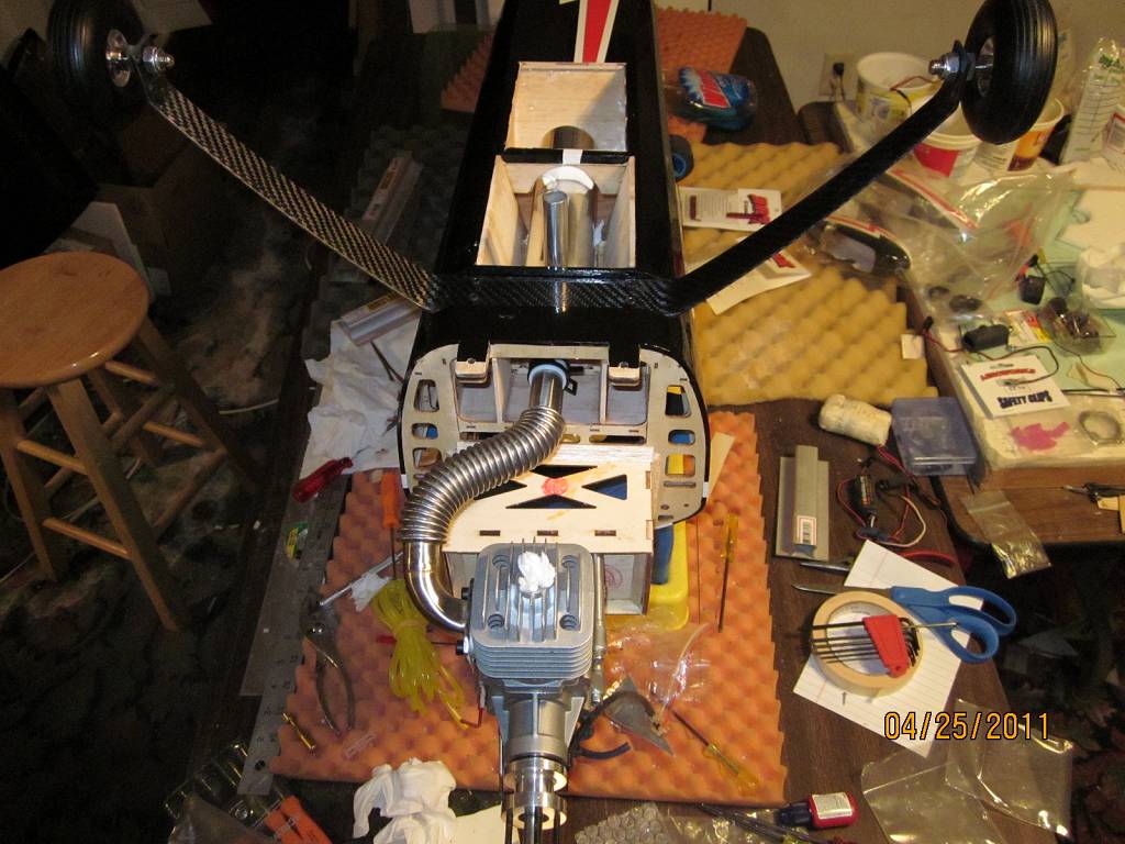

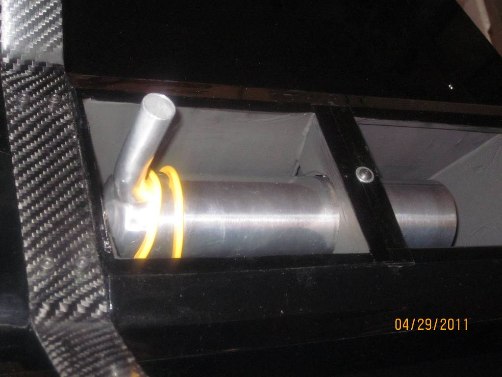

I pulled one of my first V2 (rear carb) DLE 30's off a GW Yak 55-SP, and put it on a new Pilot RC 30cc Sbach The Engine Has some where around 30 to 40 hrs on it trouble free.
I also did a canister muffler tunnel modification to the Sbach. Here are a few photo's I just finished it up. I hope weather permitting to test fly the Sbach this weekend.

Jerry,
That Sbach is looking good; thanks for the detailed photos regarding your tunnel cannister!
Hope you have a good maiden this weekend!

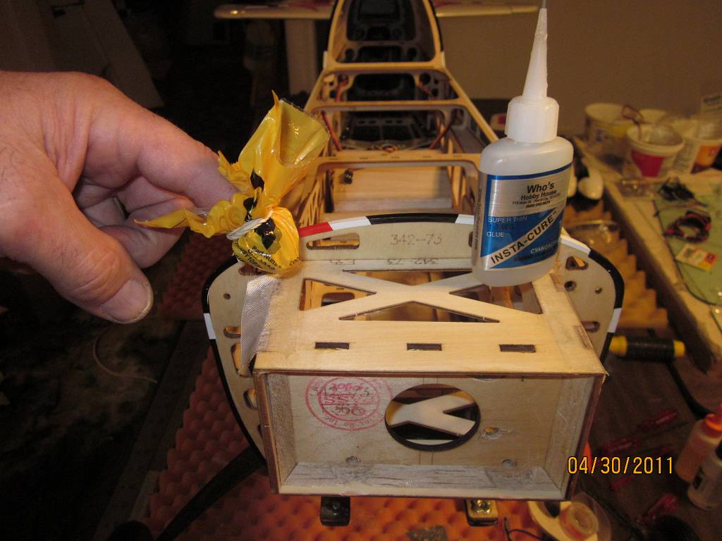

Hey guys thanks for the nice comments. I have not weighed the Sbach yet. but will get back to you on that. Depending on the type of flying I'm doing, the 2 Props I like are the Zoar 19X8 and the Zoar 19 3D-A . OH one other thing I like to do to the motor box on this size Plane is to wrap the the box with 2oz, glass and use CA to glue in place.

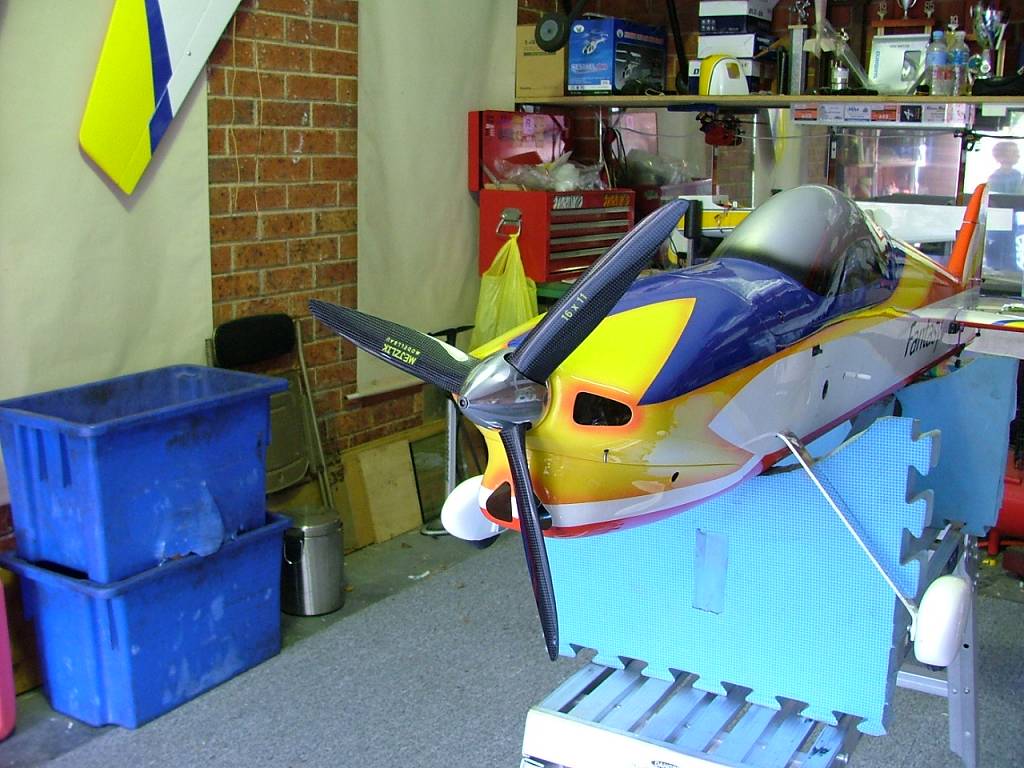

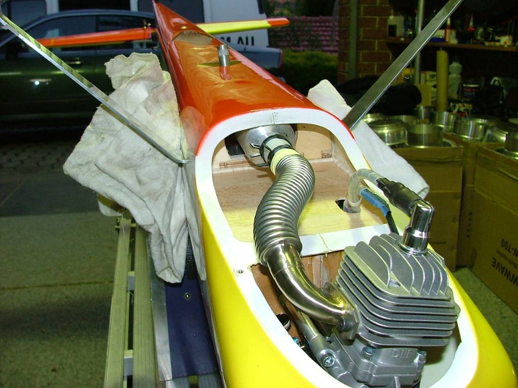

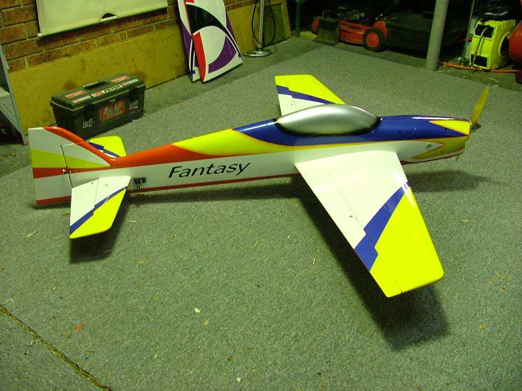

I have 30 odd flights on this plane now and it is really starting to move along .
Close enough to 5 Kg and with a China made cannister it purs along .
It can do ANY flight sequence I can throw at it and has true unlimted performance .
The DLE 30 is not a toy nor is it a subsititute for a "better brand" , it stands on its own two feet
as a quality engine with performance to match .

Very nice setup you have. Where did you get the cannister and header? Is there a header availible to route the exhaust under the airplane....like for my airplane? Thanks Capt,n
Old 05-01-2011 | 11:45 AM
  #70
Posts: 507
From: Rapid City, SD
Default RE: DLE30 experiences please
ORIGINAL: captinjohn
Capitinjohn there are two chioces http://www.troybuiltmodels.com/ and http://www.3dhobbyshop.com. 3D Hobbyshop has had the ZGR Headers and can combos for the DLE 30 for some time alreadyamd TBM also has the DLE 30 header & can kits just in the last few months. The ZGR will run alond the bottom of a fusealage I believe . I could have done that with mine but as an Old Timer, I can't leave well enough alone. I have to ,modify, modify, modify. In the long run it takes me 2 weeks longer to finish a Plane.
