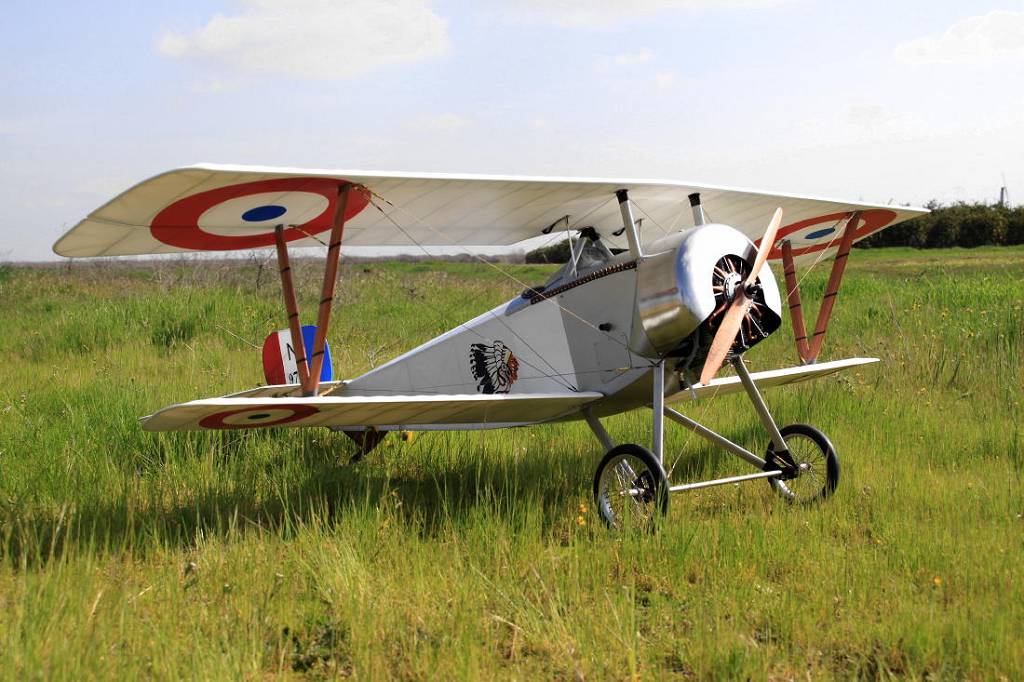

MR. SUMMERWIND, MY WISDOM FOR YOU, REGARDING GAS ENGINES, IS THIS... ON A DLE ENGINE, THE PLUG THAT COMES WITH IT SEEMS TO HAVE A VERY SHORT LIFESPAN. OF COURSE, THAT IS NOT IN ALL CASES, BUT FEEL FREE TO TAKE YOUR CHANCES, WITH THE PROVIDED PLUG, IF YOU LIKE. NGK PLUGS APPEAR TO BE A VERY RELIABLE PLUG. THIS WISDOM IS BASED ON MY READING AND COMPREHENSION SKILLS THAT I USED IN THIS SUBJECT FORUM ALONE. MR. jedijody IS THE ONE I WOULD RECOMMEND YOU LOOK TO FOR ENLIGHTENMENT... AS I AM NO EXPERT ON GAS ENGINES FOR RC AIRPLANES. THANK YOU FOR YOUR RESPONSE EMAIL TELLING ME THAT MY EXPERIENCE IS SOMETHING WORTH LAUGHING AT AND STATING THAT WHEN I LEARN TO BUILD AND FLY AS YOU CAN, I CAN INSULT YOU. I HAVE NO DESIRE TO INSULT YOU AT ALL. MY PREVIOUS POST, TO YOU WAS AN ATTEMPT TO HELP YOU SEE THAT IN YOUR 20 POSTS, ON THIS ONE SUBJECT, VERY LITTLE KNOWLEDGE, IF ANY, WAS SHARED BY YOU. THOUGH MY EXPERIENCE IS ONLY 2 SEASONS OF FLYING, MIND YOU OUR SEASONS ARE PRETTY SHORT HERE IN CHICAGO, I HAVE BEEN TOLD BY SOME OF THE BEST FLYERS IN THE CLUB THAT THEY CAN'T BELIEVE HOW FAST I AM LEARNING TO FLY SPORT AND 3D MANEUVERS. HEARING SOMEONE SAY THAT I CAN FLY BETTER IN 6 MONTHS, THAN THEY COULD IN 23 YEARS, SAYS SOMETHING....I'M DOING ALRIGHT !!! THE GUYS LIKE IT WHEN I FLY MY OUTLAW AT AROUND 125 MPH, ALL AROUND THE FIELD. I HAVE ACQUIRED 7 AIRPLANES, IN 2 SEASONS, AND HAVE YET TO START MY 19TH GALLON OF FUEL. I THINK IT'S SAFE TO SAY, THAT I AM MAKING PROGRESS. AS FOR ENGINE WISDOM, EVERYTHING I OWN WITH A ENGINE,... PURRRRRRS !!! I HAVE NOT SCRATCH BUILT ANY AIRPLANES YET, BUT I HAVE HELPED BUILD SOME AUTOMOBILE ENGINES, MANY HOUSES, MALLS, SCHOOLS, MEDICAL CENTERS, POLICE STATIONS, OFFICE BUILDINGS, EVEN A HANGAR... YES THE ONES THEY PARK REAL JETS IN, AND A COUPLE DOZEN SNOWMEN. I HOPE MY SARCASM IS NOT OVERWHELMING. IF YOU TAKE A LOOK AT YOUR POSTS AND COMPARE THEM TO THE SUBJECT, YOU WILL SEE VERY LITTLE FOCUS ON THE SUBJECT. THAT'S WHAT I HOPED YOU WOULD UNDERSTAND. DO YOU RECALL SENDING ME THIS........
looked at your profile and pics....LMAO
when you learn to build, then by all means, feel free to insult me, but til you can build and fly something like this, you really should keep your feelings isolated from the talk forums.
I FAIL TO SEE HOW ME BUILDING OR FLYING THIS BIPLANE WOULD WARRANT ME TO BE INSULTING TO YOU OR ANYONE. I'LL TAKE YOUR SUGGESTION UNDER ADVISEMENT AND I'LL RETURN THE FAVOR... BEING SENSITIVE IS GOOD,... BEING OVER-SENSITIVE IS NOT. YOU ARE WELCOME.
BY THE WAY, DID YOU BUILD THIS BIPLANE?, IS IT YOURS?, CAN YOU FLY IT? REGARDLESS, SHE SURE IS PRETTY AND IF YOU BUILT HER, YOU HAVE SOME AMAZING TALENT !!! MERRY CHRISTMAS !!!

It would take me 10 years to build a airplane like that neat old Bi-plane! Capt,n

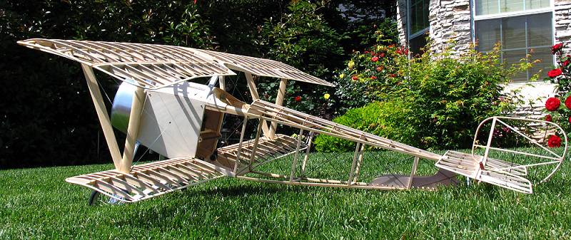

well i do have a pair of 2+ power reading glasses
took me 2 years to build.

There is something in me that always said "GET A PLANE LIKE THAT" but I would not dare to fly one...that nice. Very good job Summerwind!
Capt,n
