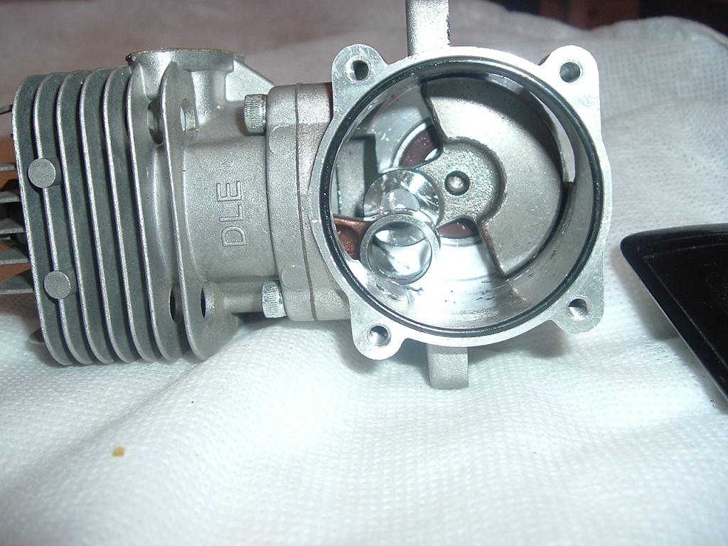

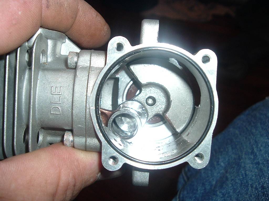

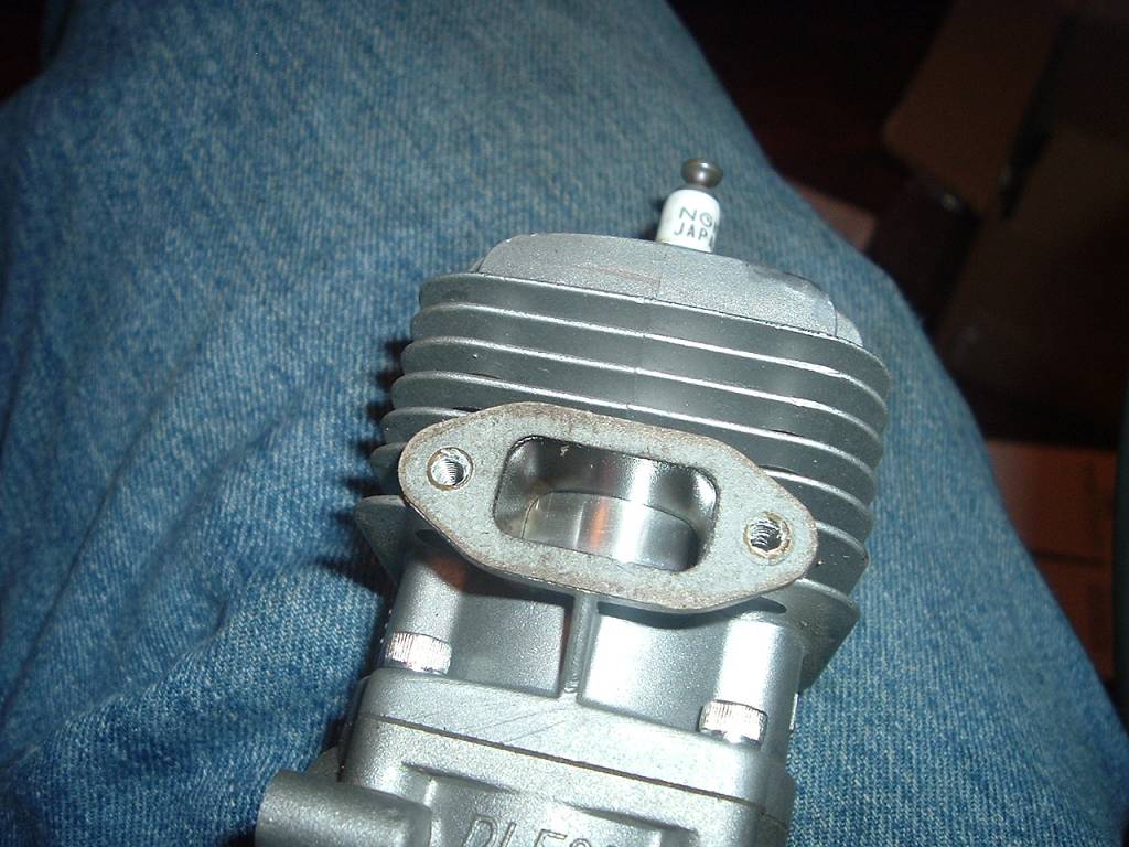

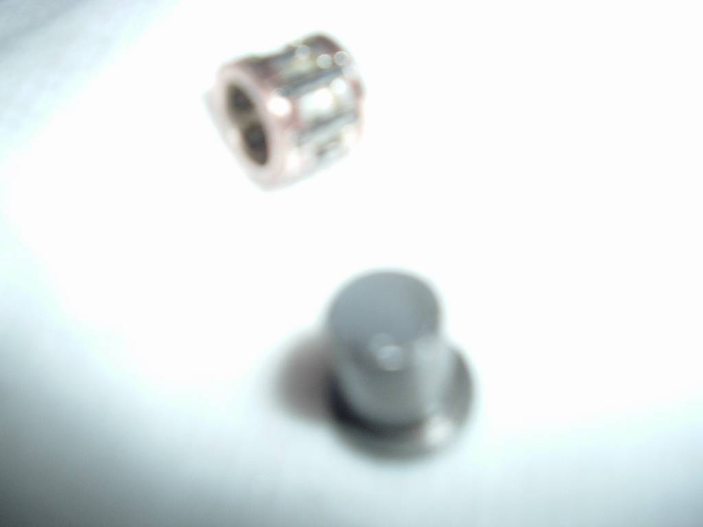

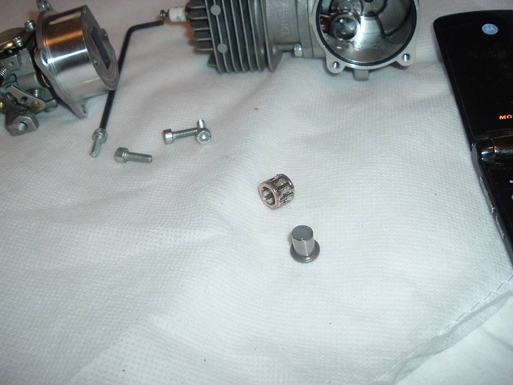

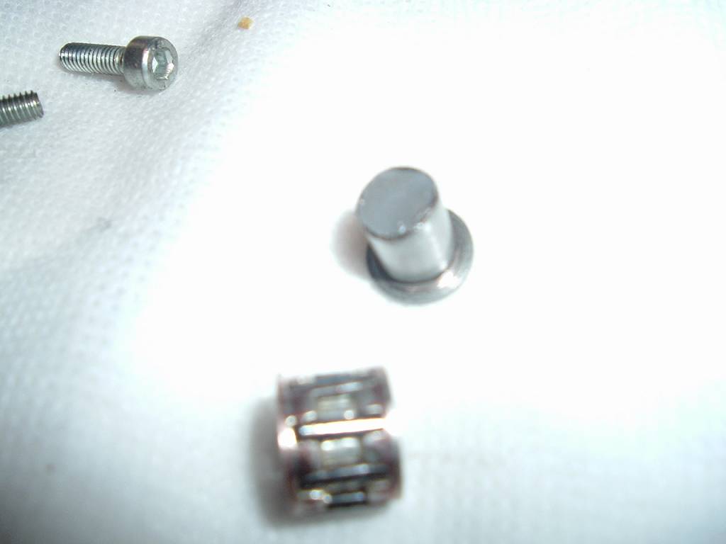

Here are the pics, I will let the dle experts make the call!

It broke the crank pin, a few others have done the same thing, it's the only failure I've seen in the DLE20. Send it in, it'll get replaced, no big deal.
Old 06-16-2011 | 01:35 AM
  #53
Joined: Apr 2010
Posts: 2,744
From: Cape Town, SOUTH AFRICA
Default RE: DLE-20 issue
+1 typical of fatigue due to over reving or embrittled steel making up the part. Should be a straight warranty replacement.
