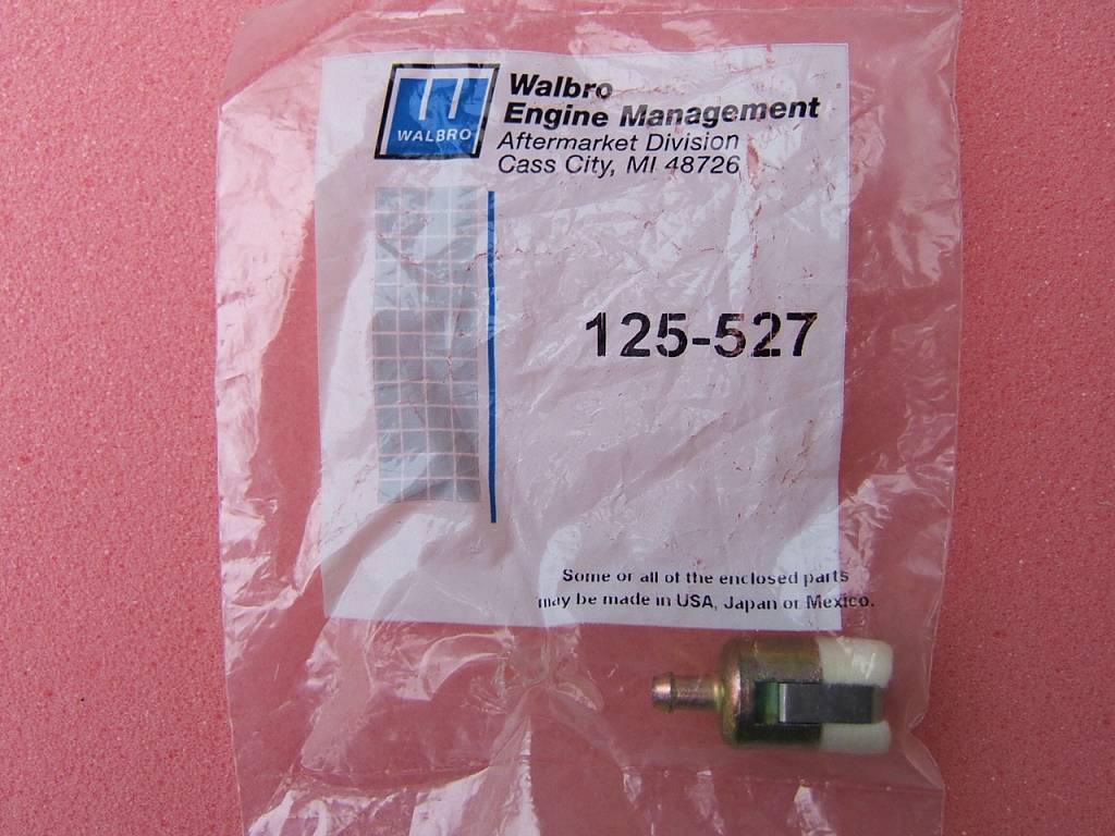

The problem is with the fuel system not the engine. A few questions, What type of tank setup?, What type of pickup in the tank?
No matter how much foam or insulation you have around the tank the vibration on the gassers will make the fuel foam, you will reguire a filter/pickup as fitted to ALL weed eaters/chainsaws to correct this, this will fix 99% of all fuel problems. Walbro make a great one.
You will need to run it slightly rich untill you have run around 1 gallon of fuel through the motor as they take some time to runin.
As has been stated, replace the DLE plug with an NGK this is done by the importer down here.

I am running the OS bubble less clunk like I run in all of my tanks. The fuel tank is a three line system and it is the stock tank that came with the GP Pitts S-2. I really suspect that the line has come off inside the tank. I have a a flairing tool that I can flair 1/8 tubing so I will do this tomorrow and wire everything on. As far as the tuning goes since I am new to gas how does it differ from glow? It is easy to tune glow but gas seems to be a different animal. I have good ventilation into the cowl and my buddy has the same motor in a GP Ultimate and his engine is a cool as can be after the flight so I really am suspect to the plumbing. Like I said I will let you know tomorrow when I yank that tank.
Old 07-03-2011 | 03:05 PM
My Feedback: (57)
Joined: Feb 2008
Posts: 102
From: Huntersville, NC
Default RE: DLE 55 Issues
Is that filter/clunk available at the local level?

Posts: 102
What Walbro Filter/clunk would be used for a 55cc motor. That number above said good up to 30cc!

ORIGINAL: futura127
Mate, your clunk will do fine to weed out any running issues.
It's "nice" to have the Walbro felt clunk but not essential.
I personally only have them in some of my planes. I use the stock clunk that came with the tank in many of the others and with no ill effect

ORIGINAL: futura127
Same as the one in the picture. Don't believe that 30cc limit number. It's good to above 150cc.
