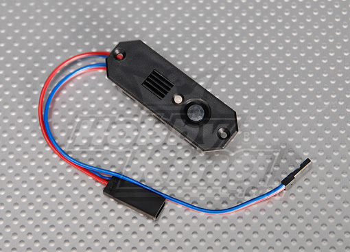

Hi to all
Is it safe to operate an rcexl ignition with LiFe 6.6v
i have a digiswitch on the my plane and it's work fine with Lipo 7.4v
but when connecting a LiFe 6.6v the digiswitch will not turn on it's blinking red+green
replaced back to LiPo and it's worked fine again.
thanks
ilan

Page 5 and 6 detail how to change input settings.Hope this helps
[link]http://www.powerbox-systems.com/shared/download/bedienungsanleitungen/DigiSwitch_EN.pdf[/link]

Thank you mighty9
i didn't know that it can be change ohhh the technology
ilan
