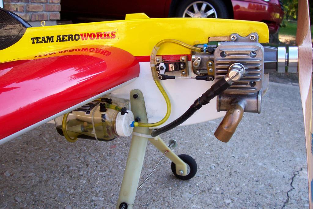

ORIGINAL: airborne2.4
ORIGINAL: Garyav16
Just go to this site and buy one of these awesome fuel tanks.
http://www.fourtituderc.com/
Install the thing and FLY!
http://www.aero-works.net/store/detail.aspx?ID=488

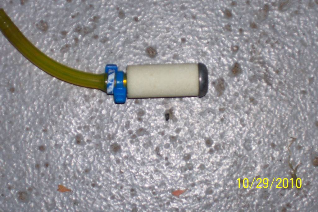

Those started out over here;
http://www.aerographix.biz/fuel_tanks.htm
Yep, cool tanks & the clunk is easily seen!
For their shorter 8 ounce tanks (ONLY), a few mods are needed (their clunk is too light & std tygon isn't flexible enough in such a short tank).
The ceramic clunk/filter I prefer is a Poulan 530095646, and weighs 0.4 ounces.
More flexible fuel line;
Oregon [part #07-266] .094" I.D. x .203" O.D. [wall thickness=.050"]
{Std Tygon 1/8" I.D. x 1/4" O.D. [wall thickness=.060] }
ONLY required in their shorter 8 ounce tanks.
I always use zip-ties and never ever had any leaks!

Another point is that some people use a filtered clunk. If you use a -T- with a filtered clunk, then you are putting unfiltered gas directly into the Carb line. To filter properly using a filtered clunk, you must use a 3 line system.
ed
Actually, you can do that at your gas jug itself and be just as good as a 3 line but use a 2 line w/'T'.
Put a good quality ceramic clunk in your gas jug and the gas tank, and the 2 line can't get unfiltered gas.
The ceramic clunk/filter I prefer is a Poulan 530095646.

Looks nice A1 Where did you get the ceramic clunk/filter?
Old 11-28-2011 | 06:54 AM
  #46
a1pcfixer's Avatar
My Feedback: (7)
Joined: Aug 2004
Posts: 2,505
From: La Porte, IN
Default RE: Three line fuel system
Most small engine repair shops that work on chainsaws, trimmers, edgers, etc., have -or- can get them for you.
