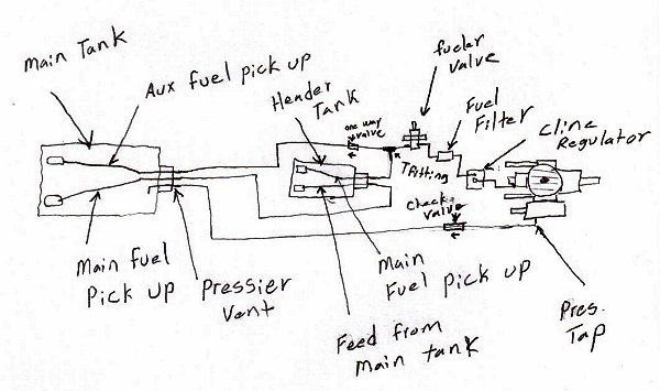

You running one or two lines to the header tank?

Gassers don't need or use the pressure tap and Cline regulator, it's built into the carb...That;s where the idea for the Cline regulator came from, a Walbro pump...
