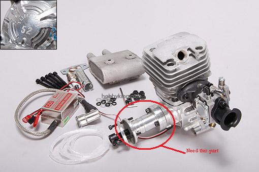

I have a 52 gas engine from HK (1st mistake) that the shaft that holds the prop on was drilled off-centered. I cannot get any place with HK. What would that part be called. On the prop end it has a 10mm x 1.5 socket head bolt holding the prop on. The other end is bolted to the crankcase by 3 bolts. The unit itself is about 2 inches long. I don't know what it is called and don't know where I might buy one. Like I said, after many emails to HK it looks like I am going to end up with a paper weight that looks like a gas engine. Thanks in advance for any help.

Hummm! went to truturn but could not find prop bolts. The part I have circled is the part I need. Drilled off centered and causes the prop to wobble.

I would call it the crank extension prop mount

Close, thats the prop hub and its held on by the prop shaft secured to the crank.

prop hub.
Go to a machine shop and have them machine a centered oversize hole, then install a 10mm helicoil.

Prop hub adapter off of a CRRC 45 wil fit it.I replaced the prop hub on my FTL-45 from HK with
a CRRC prop hub around 3 years ago and still flying it on a H9 Extra 260.
Bought mine from western hobbies,but I can't find them now.
Might can try taildraggerrc.com,he sells CRRC engines.
maybe he can get it for you.

“Are you sure that the crank spacer is bad?â€
If you had a prop strike that would of very likely of twisted the crankshaft and this is very typical of any engines that have a crank that is pressed together. The good news is; is that it can be straighten very easily. You will need to check the crank with a dial indicator.
