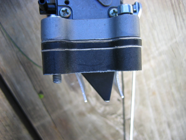

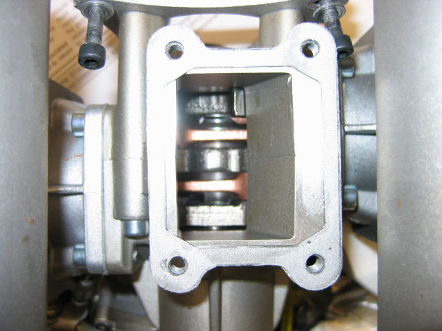

The I/M is cast offset from center & with an angle that allows crankshaft/rotation/direction to assist in the intake charging process....

Yes, even the "Reed/Block" is "Directional".....
