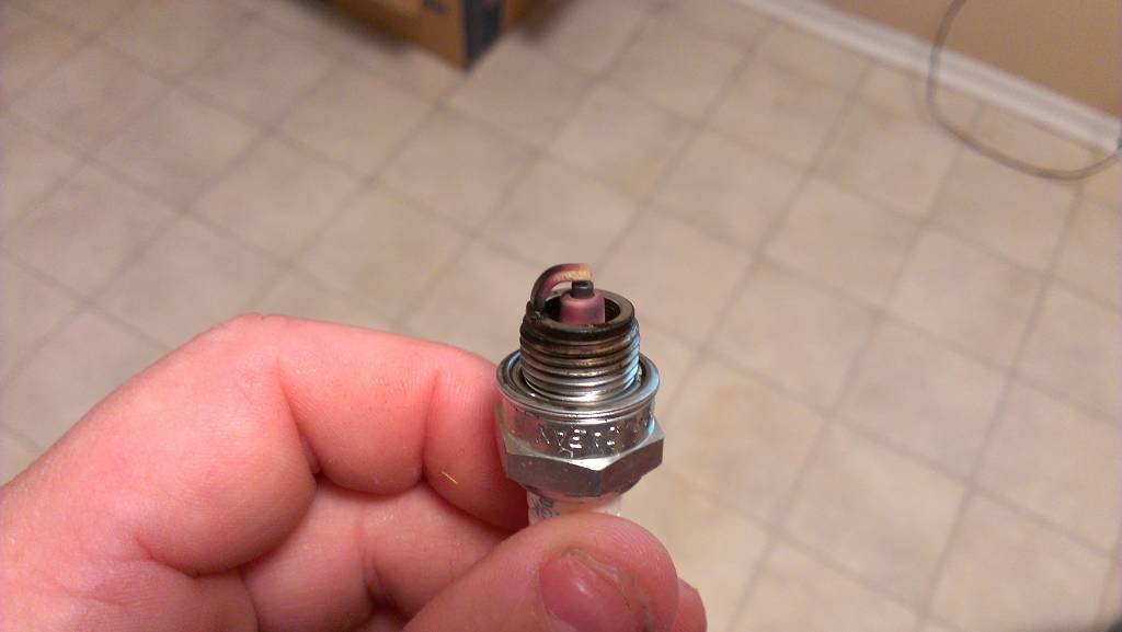

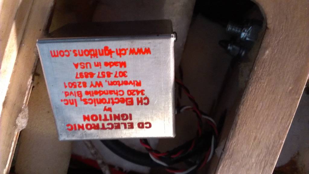

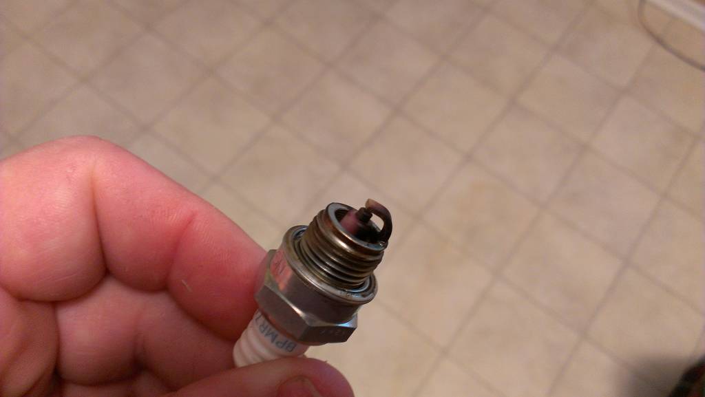

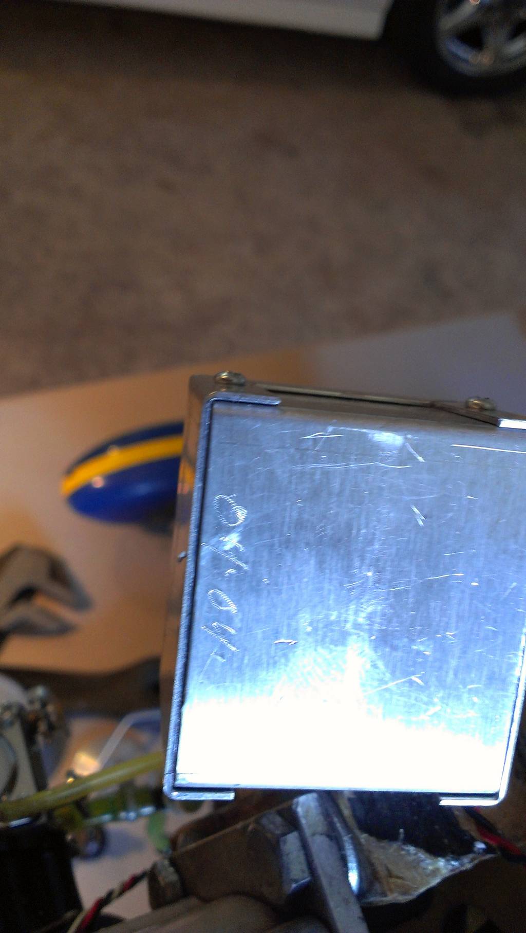

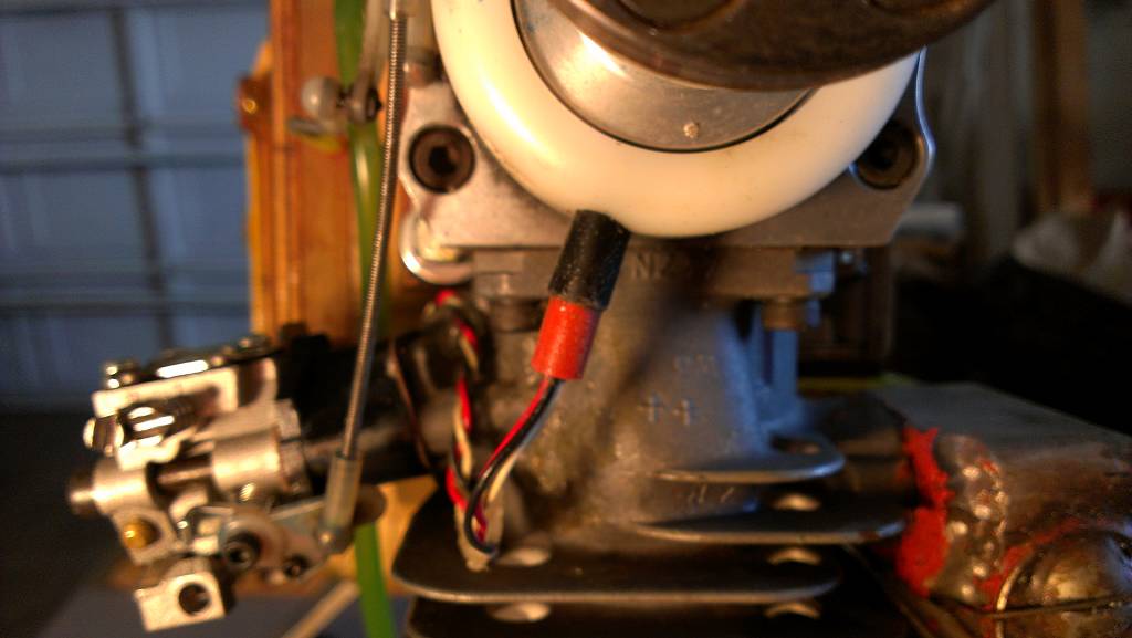

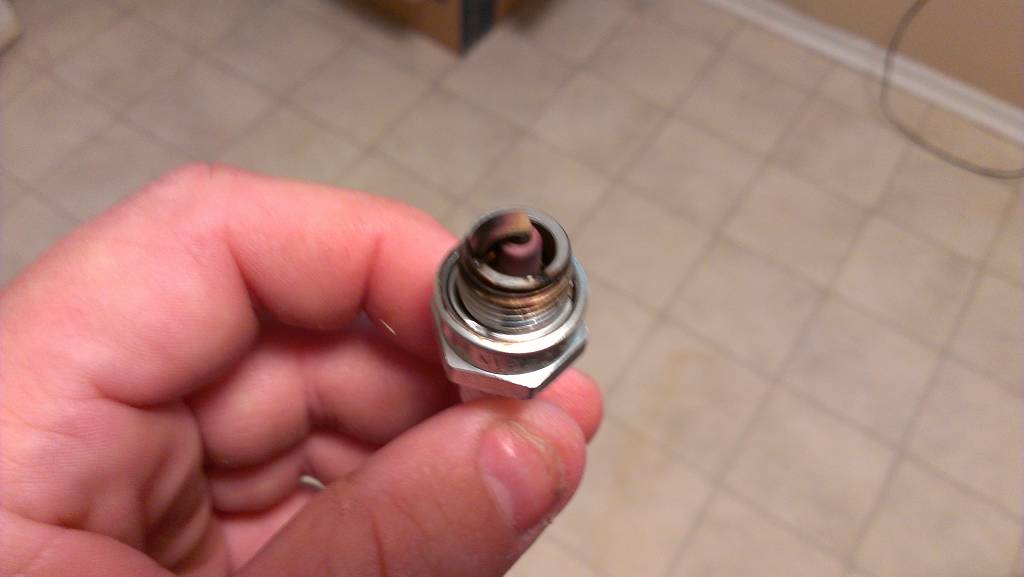

A couple more requests .
Can you post a close up well lighted picture of the electrode end of the spark plug you have been using .
A picture of the ignition timing ring showing the pickup sensor gap
look on the C&H module for etched letters ,there should be a date and possibly an S or Synch also etched . On your engine with mechanical timing there should NOT be an S or Synch.
You have the correct plug , correct carb. ,adequate battery size .

here are a few pix

and a few more pix,, didnt see anything scribed on the engine, and on the ignition module box, the only thing scribed on it was on the back, it was 04 04 guessing thats the date. I am going to try and check the timing using the method on the video that All Day Dan posted (thanks) and try to see what the timing is,, if I cant figure this out I guess Ill have to remove it and send it to brison, Gonna keep working on it though,,thanks for any help,,Lord knows I need it

Use the video that was posted by All Day Dan for checking the timing . Be sure that the throttle is wide open when checking the timing that way it wil be at max advance. To adjust the timing on the Brison adjust the length of the linkage that goes to the timing ring . I would set the timing at 30 degrees before TDC at wide open throttle . It doesnt matter what the idle timing is at this point . Get a new plug and gap it at .020 . Set the needles initialy at 1 -1/2 turns open each.

Old 10-08-2012 | 03:49 PM
raron455's Avatar
My Feedback: (38)
Joined: Sep 2012
Posts: 1,133
Received 15 Likes on 12 Posts
From: Waco TX
Default RE: older brison 3.2 questions & problems
CK1, I followed your directions to the letter, here is the result. I started with the timing, it was 21 degreess at wot, i set it to exactly 30 degrees  btdc at wot, i then put in a new plug gapped at .020, then set both needles out  1.5 turns. I fired the engine up and immediately knew this was a different engine. i adjusted the carb just as described, no miss, no sputter, got a great transition to full throttle max rpm with the 22x10 prop hit 6720rpm, throw the stick back down to idle and the engine goes to a great steady idle, then floor it great transition back up to max rpm. running fantastic, needles didnt take too much adjusting. i would say this thing is running perfect and is an absolute beast. i have a few questions, i am running the 80:1 mix with the amsoil and premium, i run that because my manual recommends that and alot of other brison owners run that mix,,is that ok i know some other members stated thats no good earlier in this post.  Also i seen some air bubbles in my fuel line while adjusting (although the engine never missed that i heard),,this setup does not need positive pressure fron the muffler does it?  <font color="#FF0000">CK1 I want to thank you for taking the time to help me, i was right on the edge of pulling it and sending it out for repair. I am truly thankful, you helped me fix this problem, and if you come to waco texas you look me up,,there is a steak dinner here with your name on it, thank you so muck SIR.</font>
