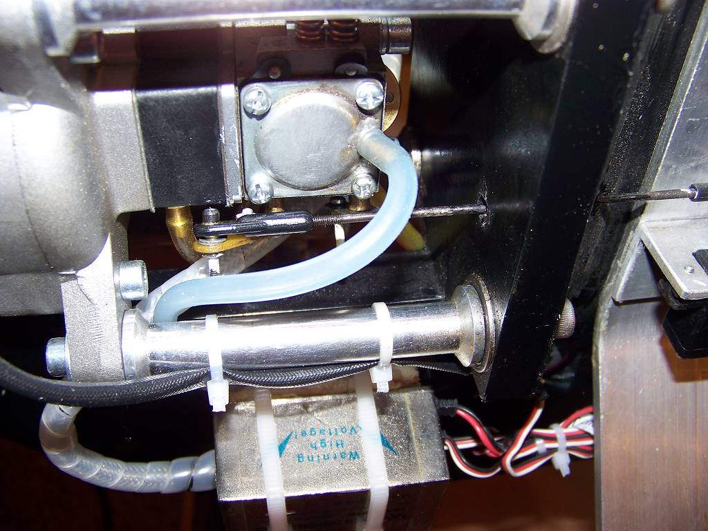

Hey guys, I have a brison 3.2 in a zero I am flying. This engine is great and really hauls the mail. My question is that when I tune it on the ground, it has an awesome transition from idle to WOT. When I am flying at anything less than 3/4 throttle, it seems to burble or sputter. Transition is still good while in the air and i can blip the engine from idle to higher settings to control decent on landings for example. This effect does not seem effect the running of the engine and when throttling back up it readily responds. I just dont want to get into a dead stick situation while flying.

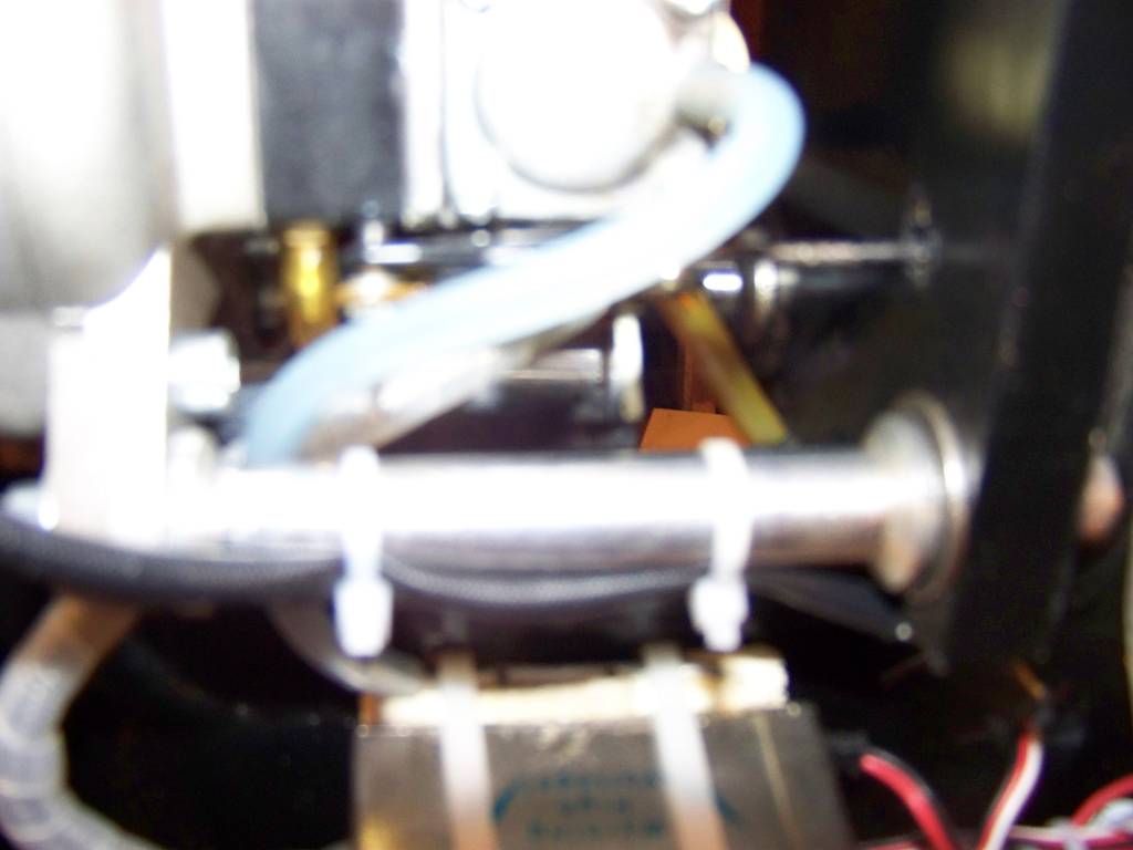

may be air preasure in the cowl is making your carb pump more fuel in then needed.try venting your carb diaphragm cover,the one with the small hole in it, to out side the cowl.this has work real well in the past for me when i had the same trouble.you can just make out in the one crapy picture the aluminum tube on the end of the fuel line,with the end of it pinch shut with two small hole drilled in it.it is tuck in just between the ignition and fuse,under the jip ties.

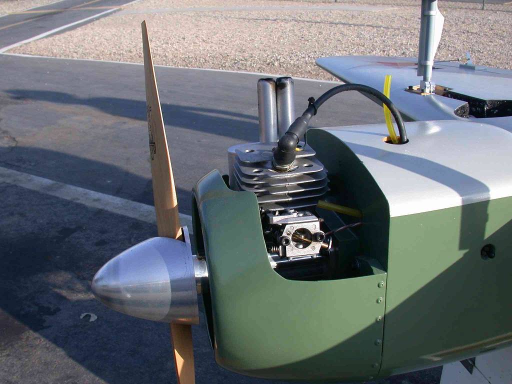

closetguy, the cowl doesn't have a lot of outlet for air to pass thru. Not horrible. But a typical radial cowel installation. A little space on the sides by design and a 1/4 or slightly larger gap around the head as it protrudes a bit. Will try this too.

now, sense you said you have a round cowl that is the problem,to much air and no were to go.run the vent line out the bottom of cowl,in between the landing gear.solder a brass tube to the diaphragm cover,at the other end of fuel tubing put a two inch piece of brass tube,pinch one end shut,drill two small holes one inch apart in tube.your troubles are now over.

How about a picture of the cowling front and bottom so we can see what you have .
I have the front area blocked off with a dummy radial with only an opening slightly smaller than the size of the cylinder to let air in . Under neath I have several openings to allow a negative pressure condition to allow the hot air to escape .

no sense in cutting everything up,when five minutes to vent the carb diaphragm cover will give you the same tuned carb on the ground as in the air.also it may not take care of the problem for sure.i had to do this mod.on a 50cc profile with the entire engine expose,but it did cure the air passing over the cover plate vent hole.
i never had to do this mod for any of my planes until i started to fly round cowl planes,it takes care of the problem.
i like it so much that i do it as a routine for every plane i set up,just in case.

Still working on pics of the cowling.
