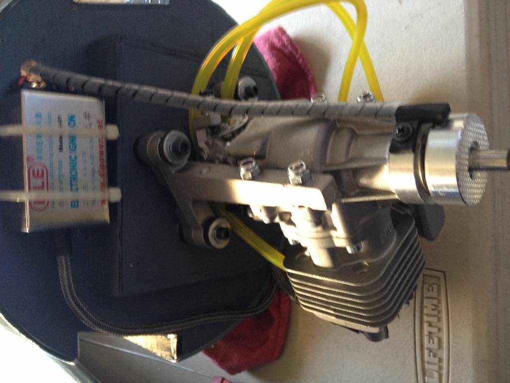

I relent and bow to your experience, gents...
here is the DLE 20 recently liberated from the ill-fated Sukhoi and it plugged right into the new BH FW 190a...
should I be worried about the fact that the carb has what seems like very little breathing room?

You can be that close or closer and it won't disrupt the carb. DO NOT get the urge to cut a hole in the firewall behind the carb.
I say good choice on trying that engine first
I think you will see that it may be a hard job(maybe not impossible) to try and stuff a much larger engine in there.
