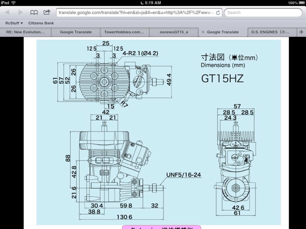

Well did some more searching and as far as I can tell, no OS yet, and the only OS is still for Heli use. If you look at the pictures you can not put a prop on this bad boy. The engine that's supposed to go to market has changed a little from the concept engine. The carburetor hangs out past the drive washer, but this is intended for Heli use.
Considering the GT22 is priced at 409.00 you would have to imagine this one being in the upper 300.00 price range.
http://translate.google.com/translat...jp%2F121213%2F
http://www.os-engines.co.jp/english/...newsgt15_e.pdf
The Evolution will more than likely a better choice for most modelers based on OS's pricing history.

That's a 15cc heli engine. Where's the engine for an airplane.

Yep! That's what I said in the post, it's a Heli engine and can't find any sign of an airplane engine!
