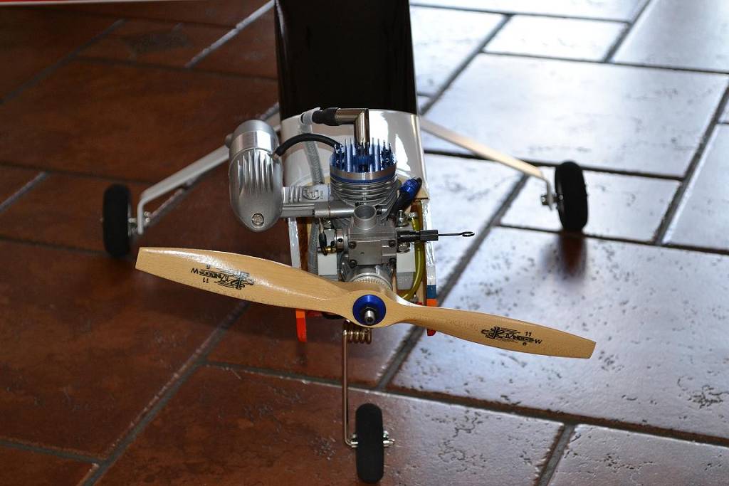

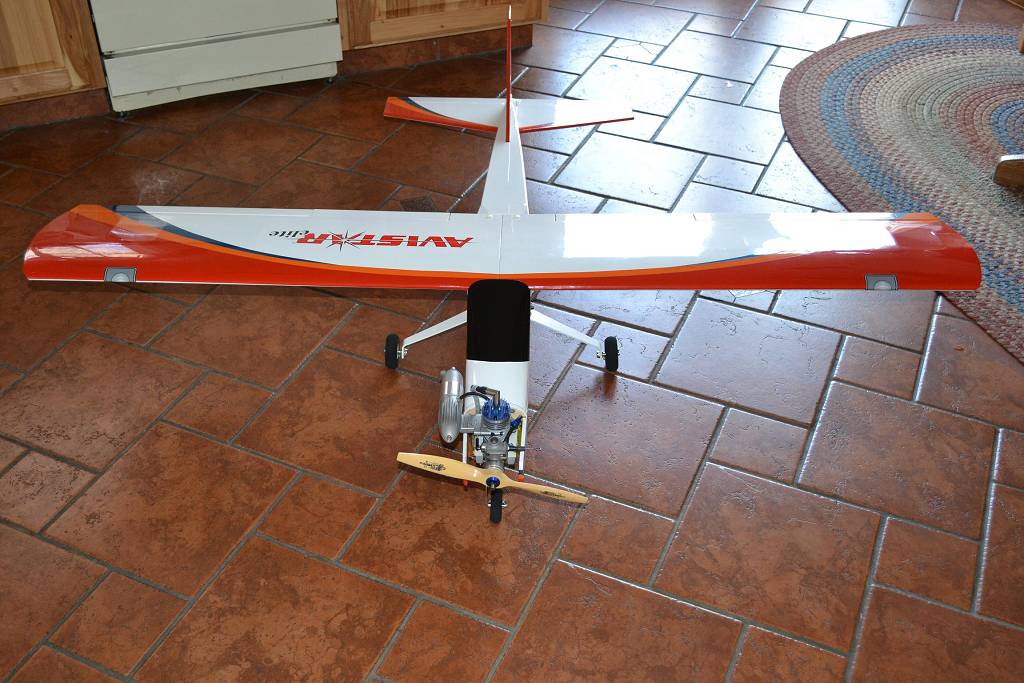

Glad to hear that your Funfly 3D flies great, so the Evo 10 should fly my U Can Do 46 with no problem when I get ready to do the conversion. Here are some pictures of my airplane ready to go. Jim
