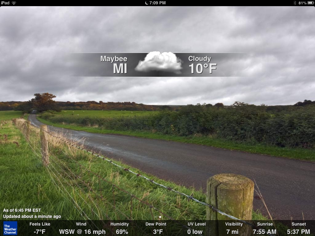

Cold?
you should be here - We lost three brass monkeys last week
I have stuff waiting to be checked out but the LiPos don't perform well at ZERO type temps.
