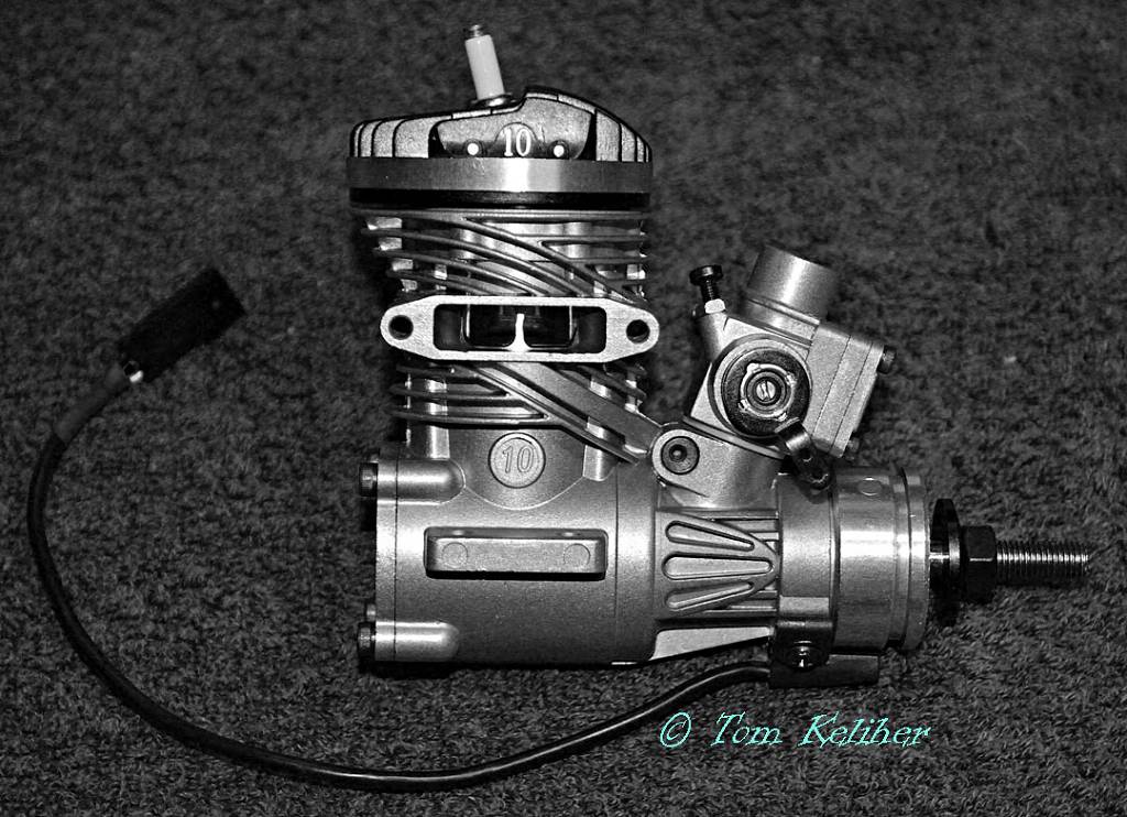

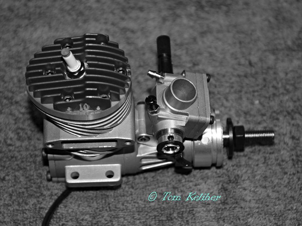

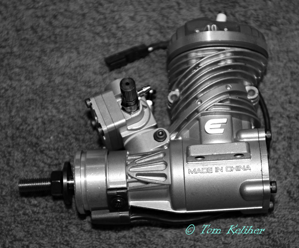

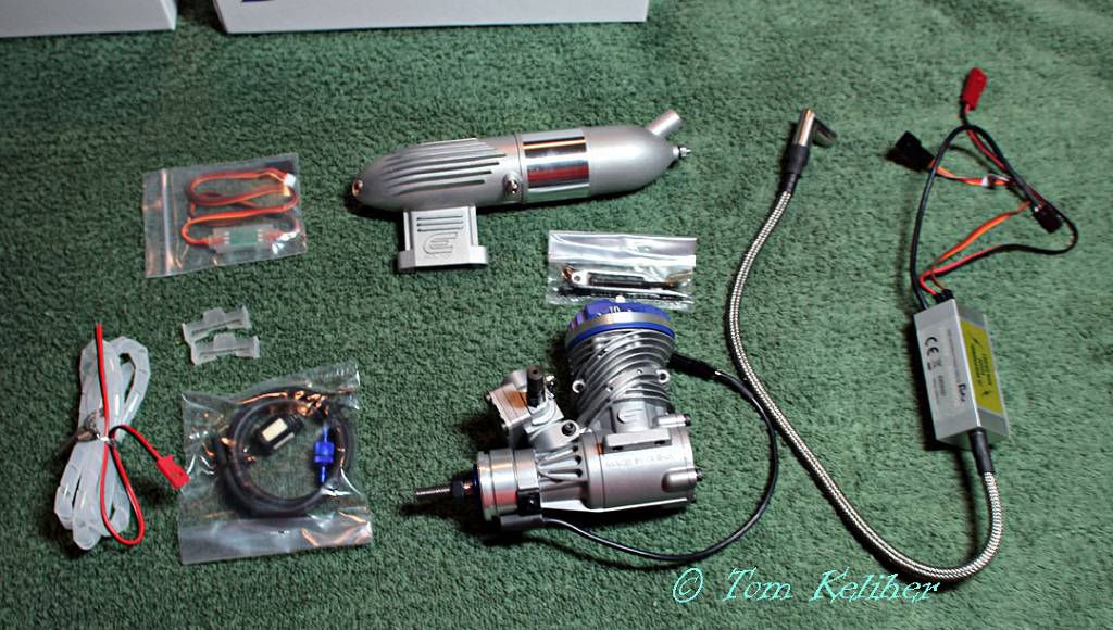

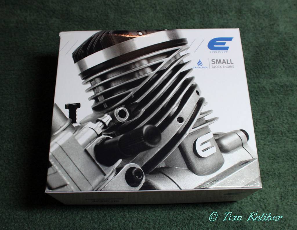

Unboxing video.
[youtube]http://www.youtube.com/watch?v=2ZqWal6Jhnk[/youtube]

Great job Kmot!
Who's going to post the first test run video?
