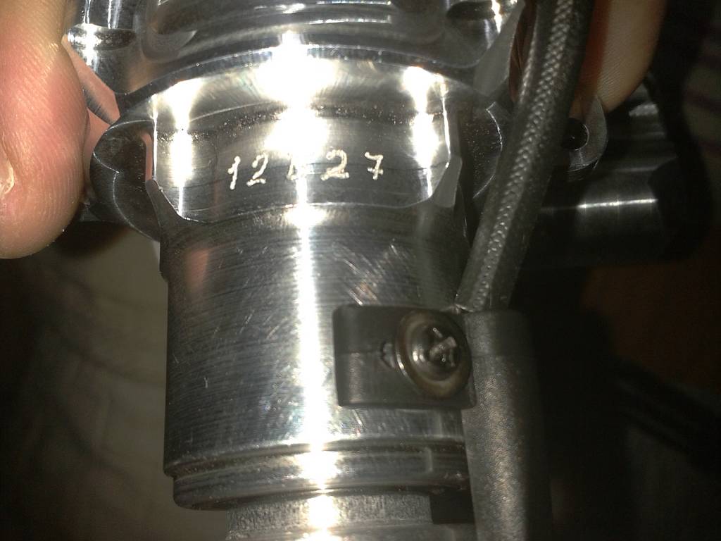

Default RE: Any problem with Mintor22
Received&iexcl;&iexcl;&iexcl;

Port machining does not appear very quality oriented in my poor eye sight.

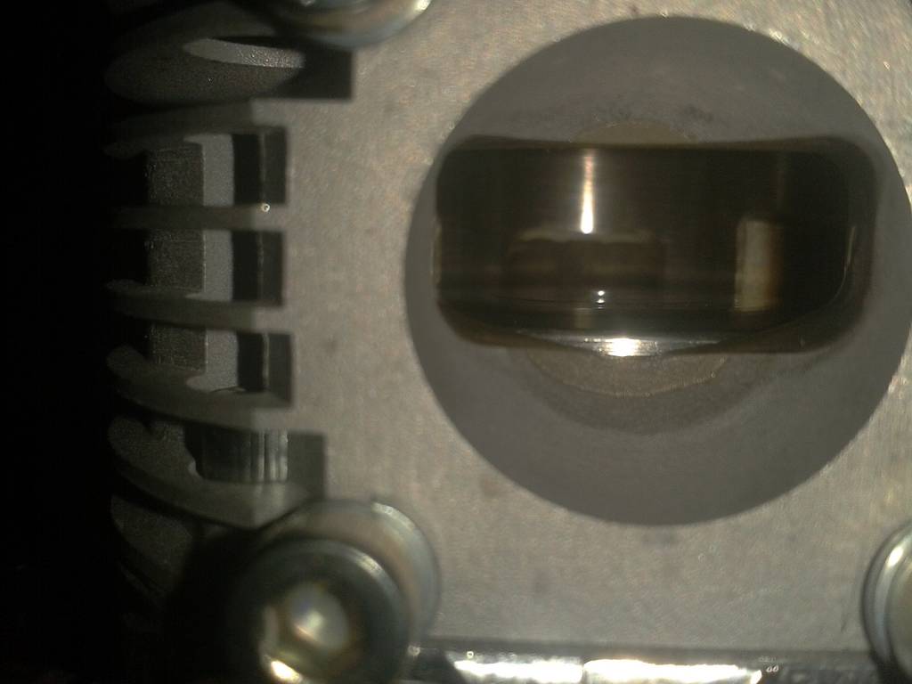

Correct the cylinder seems not fine grinding.<div>Do not know much about mechanics but fails to convince me.</div>
ORIGINAL: Granpooba
Not poor eyesite,looks like it was done by a hand grinder.

<div>Concerning the internal engine polished'm a little scared because it's the first time I see a bad cylinder polished.</div><div>Could polish better internally what interesting. I think I mention that mechanics do not know much, but my cousin is a mechanic and I'm sick of seeing motors inside.</div><div>Not if the shooting refine that.</div><div>Well I have been lucky to meet this morning to a shareholder of club buddy Castellar is, this gentleman has been foreman of the Mercedes for several years. He says he has touched 2T racing engines and the same grinding, not to worry.</div><div>In the shoot rotating refine shirt.
No problem with the engine running perfect wrath.</div><div>My old boss said if you know of one thing it is best to keep quiet.</div><div>Slds.</div>

ORIGINAL: captinjohn
Mintor 22cc engine.
This cylinder looks fine, I know this engine runs good!

Nice pictures Capt'n. In the first one it shows nicely the finger or open porting on the two ports opposite from the exhaust. That would give those ports more flow area for sure.

Needs a new ring. It's not round not even close to sealing and there is no gap (no wall tension)

Actually the ring had a lot of outward tension. Also a big end gap (a place for compression too leak) and one area of the surface of the ring seemed to be void of contact...maybe caused when the ring was finished up.
