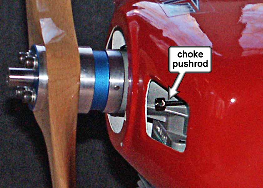

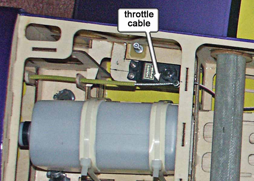

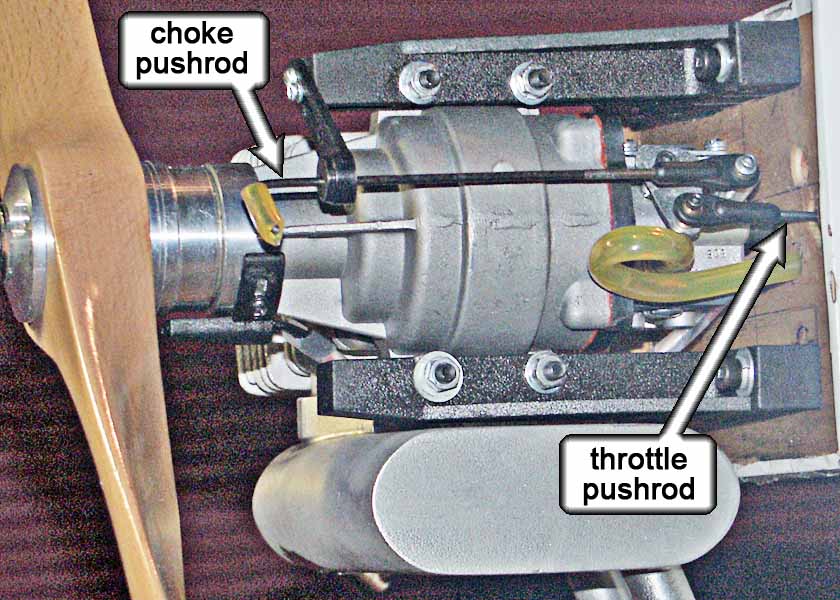

Old 02-01-2013 | 10:37 PM
Rocketman_'s Avatar
Joined: Oct 2003
Posts: 1,270
From: , MA
Default RE: Setup and throttle cable placement
ORIGINAL: rcpilotjwg
... This is my first gas setup and any tips will be terrific.
Maybe a few pictures will help clarify the explanations being given. The first 2 pictures show a side mounted engine with a manually actuated choke and a throttle arm made from a piece of aluminum. Originally, the choke push rod was routed through that extra hole in the fire wall to a servo but I decided that I had no need for an extra servo.
Pictures 3 and 4 show a different engine mounted inverted in the same airplane. The choke push rod is actuated with the fingers and does not protrude outside the cowl opening.
The last picture shows the braided metal throttle cable that I prefer because it can be routed around curves and still operate smoothly.
