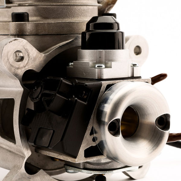

Default Evolution 62 EFI Fuel Injection
Did you guys see the new Evolution 62 EFI
Fuel injected, and no more mixture screws to mess with.....now even the electric poeple can handle a real engine
Overview
Now there’s a Giant-Scale gas engine for those who don’t want the requirement of engine expertise. The Evolution® Engines 62GXi is a potent 62cc engine with the efficiency and convenience of an electronic fuel injection system. Simple to setup and maintain, it’s a Horizon Hobby innovation that means you never have to touch a needle-valve to enjoy starting ease, reliability and long engine life. That’s because SureFire™ Electronic Fuel Injection (EFI) technology combines finely-tuned software and sophisticated sensors so the engine gets the perfect flow of fuel no matter where or what you fly.
The Evolution Engines 62GXi is the only purposely built RC engine on the market to feature an advanced electronic fuel injection system specially made for the needs of the giant-scale model pilot. There are no needle-valves to ever worry about because the SureFire EFI™ system provides smooth, reliable operation and optimum engine transition automatically, regardless of throttle position or atmospheric conditions. Just fuel, flip and fly.
Like all Evolution engines, the 62GXi is built to exact standards with high-quality materials, plus it comes ready to run with a compact 2-cell Li-Po compatible ignition and high-quality muffler. It’s the most advanced giant-scale gas power system you won’t have to touch except to fill the gas tank.
Specifications
  • Type: 2-stroke gas/petrol airplane engine
  • Displacement: 3.75 cu. in. (61.49 cc)
  • Bore: 1.81 in (46.0mm)
  • Stroke: 1.46 in (37.0mm)
  • Cylinders: Single
  • Total Weight: 66.6 oz (1888 g)
  • Engine (Only) Weight: 53.8 oz (1525 g)
  • Muffler Weight: 8.2 oz (233 g)
  • Crankshaft Threads: 4-5mm prop bolts on 30mm diameter centers
  • Benchmark Prop: Falcon 23 x 9 @ 7300 rpm
  • Prop Range: 22 x 8 - 24 x 10
  • RPM Range: 1,000-8,000
  • Fuel: 87 octane and above, synthetic oil at 32:1 ratio
  • Muffler Type: Inverted wraparound (included)
  • Cylinder Type: Ringed
  • Carb Type: Electronic fuel injection
Features:
  • SureFire™ EFI electronic fuel injection system
  • Electronic ignition system with 7.4V Li-Po battery compatibility
  • Purpose built engine for giant-scale model aircraft
  • High-quality materials and lightweight design
  • Shares the overall dimensions and mounting pattern of other popular engines in its class
  • Common muffler mount fits a variety of available exhaust systems
  • Dual ball-bearing equipped, cantilevered crankshaft
  • Common 4-bolt propeller mounting pattern
  • Built-in crankcase support means only short (50mm) stand-offs are required
  • High-quality CM-6 spark plug included

WOW! Wonder how well an EFI that small works? And looking at the pics it looks to have no electric plug in. How does it get its power?

Looks like more of an electronic carburetor than true pressure/spray fuel injection, but that is not all bad if it does
what it says and eliminates engine adjusting.

Throttle body injection.
Where is the pump? Where is the ECU? What about the engine itself? Not made by MVVS so is this just a new Chinese produced engine like most of the newer Horizon / Evolution offerings. Not really being critical here but I'm certainly curious for some of the answers. One thing I can guarantee, I won't be one of the early adopters / Beta testers.

Yea, those pics have some wires going to the carb. I wonder about the 02 sensor, is there one?

I'll answer some of the questions here.
1. O2 sensors dont work with oil in the fuel - they would last about 20 minutes so we don't have one.
2. Manufactured at a dedicated Evolution engine factory in China to a US design from our Evolution design team.
3. The Throttle Body Electronic Fuelnjection carb is US made with some overseas components.
4. It utilizes a single 2S LiPo to power the EFI and the Ignitions sytem which are wired together.
5. The electronics package os mounted riht on the throttle body and includes inlet air sensors, throttle position senssors, case temperature sensors and rpm sensors.
6. It works by using an algorithm that takes the rpm and throttle position to descide on the fuel needed.
7. The EFI automatically senses load changes and compensates for different props and exhaust systems.
8. Built in automatically controlled choke so the start is to simply flip the prop (4-6 times) and the engine starts and continues to run properly. The extra fuel for the choke will automatically stop after 10-30 seconds depending upon the starting temperature of the engine.
9. The engine mounts, prop mount and exhaust mounts match that of a DA60 so you can utilize already purchased components.
10. prop range for the engine is 22 x 10 through 24 x 10. The best prop we have tested so far has been a Falcon Carbon 23 x 9.

Thanks for the info Pete.
The EFI carb looks about the same size as a walbro unit.
Will it fit on, say the evoulution 58gx ?
Old 01-13-2014 | 07:47 AM
Posts: 424
From: Champaign, IL
It will but the programming is specifically for the new Evolution 62cc engine. For right now we will not be making this a ailable as a standa alone part.
