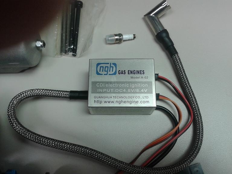

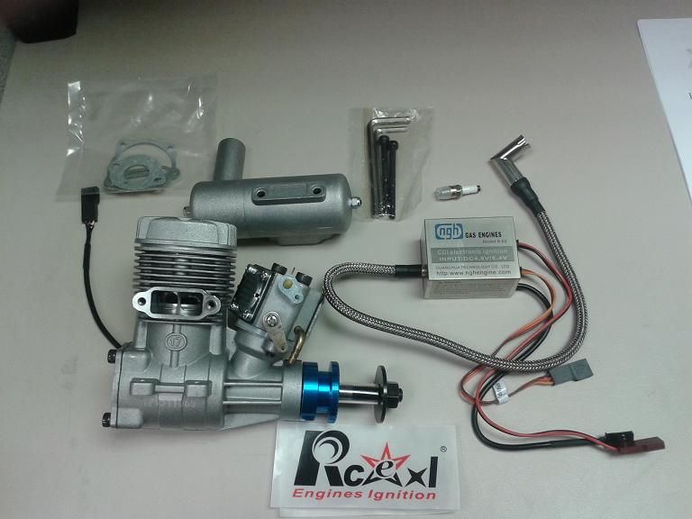

Just got the NGH GT17 in today and it looks like a great little engine. I hope to get it installed on my Seagull Cap232 this week and flying it this weekend. Here is everythin that came in the box. As you can see the carb has a thicker manifold gastket to help keep the engine heat away from the barb. I really like the new ignition that is made a RCEL. It will take a higher voltage battery pack so I can use my 2 cell life batteries with fear of them damaging the ignition.

Yes that newer version ignition module is a big improvement. My engine came with the older module that used 5v with 6.0v being the maximum input voltage. I use a Lipo with a voltage regulator on mine.

jstanton, did you have a Giles 202 a few years back? That new 17cc engine you have now looks real nice. What brand of spark plug do they provide with the engine?

I think the spark plug is a no name brand as the one that came with my engine had no markings on it.
But RCexl very likely makes them.

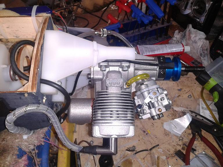

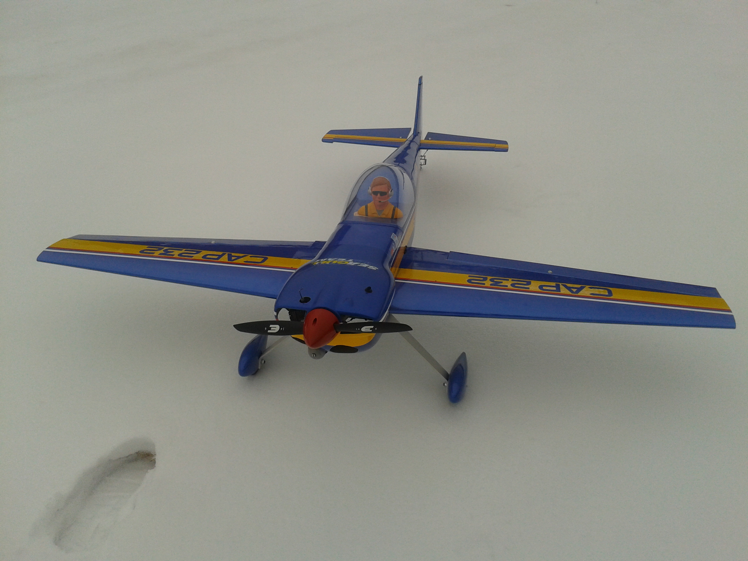

As Earl said the spark plug is a no name but since it comes with a RCXEL ignition it is more than like;y made by RCXEL. I dID HAVE A Giles 202 a few years ago but I sold it to a friend who sent it to the fly gods in the sky. i HABE THIS ncg gt17 MOUNTED TO MY Seagull Cap 232 and it mounted right to the holes I had drilled for the Old ASP 91 I took out. This engine is a little longer than the ASP so the prop spinner sticks out a lillte more thanb it did with the ASP 91. The plane balance perfectly with this engine with no added weight anywhere. Here are oa few pics on the installation.

I just got around to breaking in the NGH GT17. I have it mounted to my Seagull Cap 232 using a 2000mah life4 battery for the ignition. I have 1 gallon of 93 octane fuel with 25 to 1 Stilh synthic oil. I have a Evolution 14x6 prop. I choked the engine and it started up easy with my electric starter. I did 3 -10 min runs and the engine got better after each run. After the 3rd run I had a good 1900 rpm idle and I hit 8900rpm at full throttle for just a few seconds. I hope to do the maiden flight this coming Saturday and I will change the prop out to a APC 15x6 if I can find one at my LHS.
