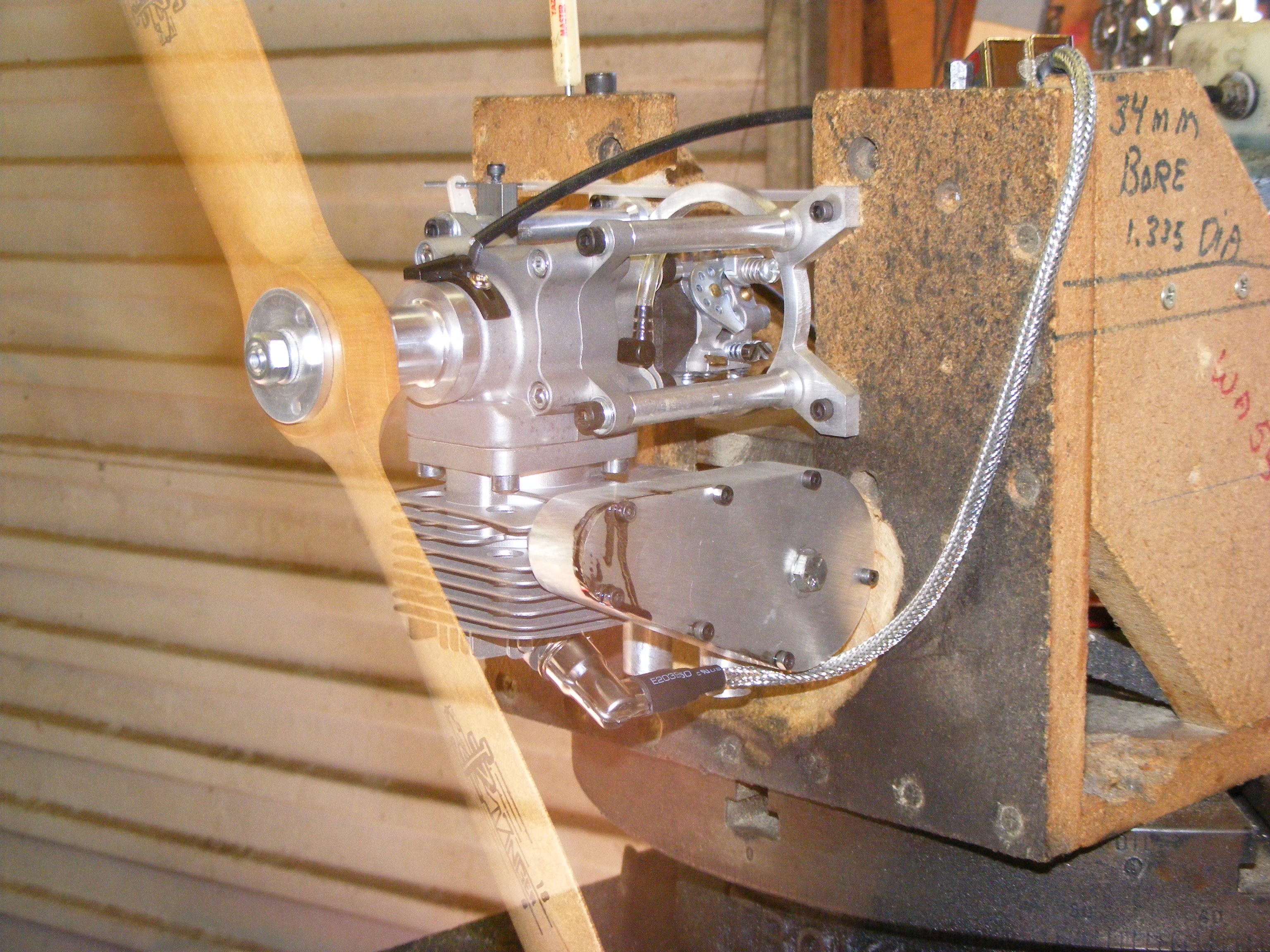

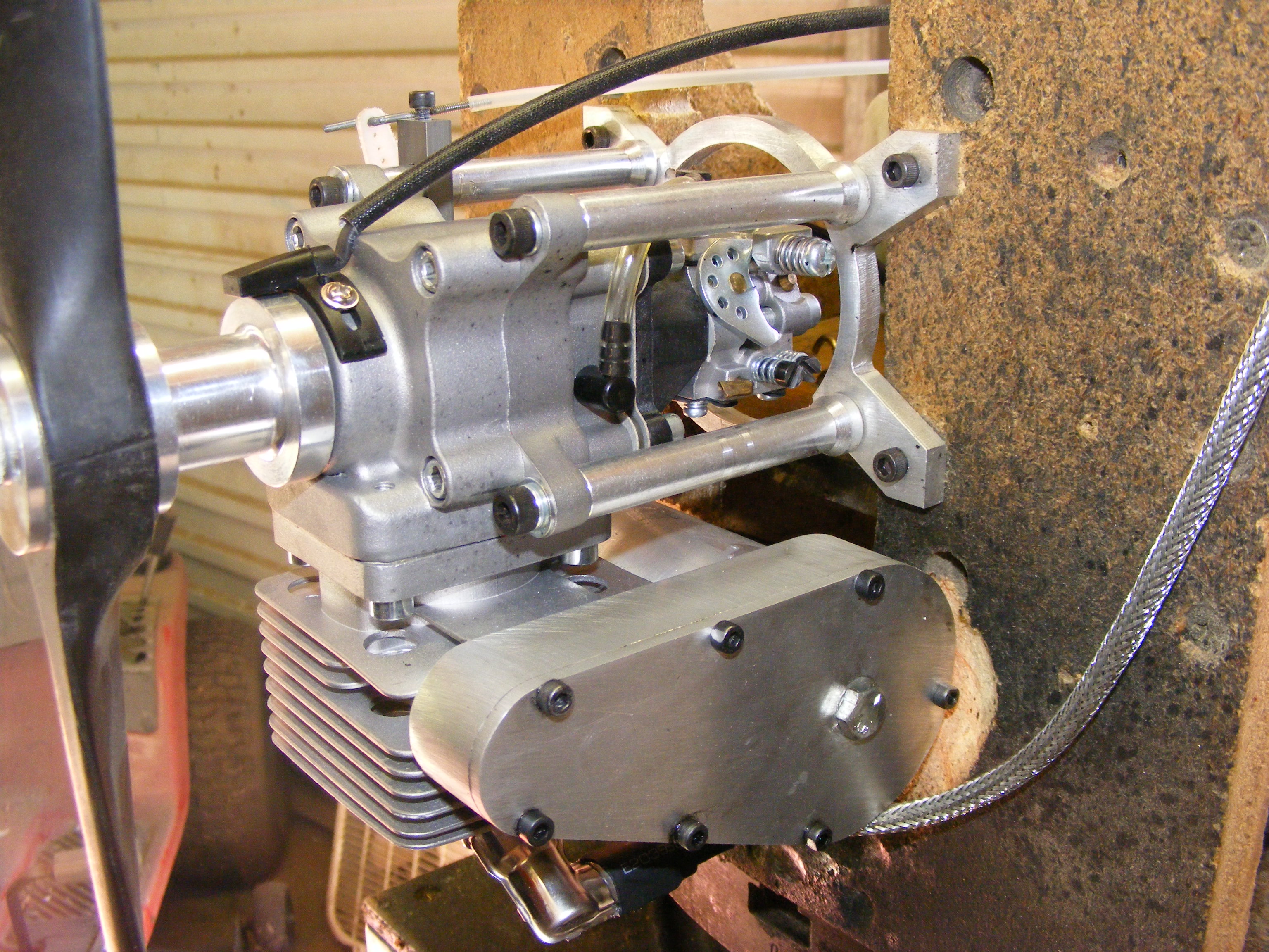

I bought 1 of the RCG 26 CC engines from Hobby King. It is $139.99 as of today. I ordered it from the US Wharehouse but it actually shipped from overseas. Took about a month to get it. It has a reed valve and 2 bearings, NTN bearings. It is rear intake and side exhaust. I made up a custom Pitts Style muffler that really works nice. I'm flying it on a Seagull Models Laser 200 with a APC 18-8 prop. I tried all different types and sizes of props but it runs the best with an 18-8. The only thing that I don't like about it is the Low End Needle valve screw needs to be open about 2.5 turns. I started at the factory settings but found that I had to keep opening it up. It's putting out about 7,000 with this prop, and 87 octane, 32-1 oil.
