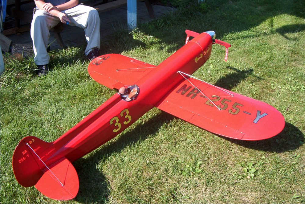

this is my 73" span Miss LosAngles from a Walt Mouchas kit,, I bought it from the builder with only one flight on it.. it had a G38 in it, and it was not enough power for good top speed, with that said this plane does have a lot of lift, it lifted off the ground at about 35%, 40% Throttle, I was surprised to find that out,. the plane kept pulling to it's left down low to land when I came off the power, I read a write-up where by this can happen if a plane does not have enough Right Engine Thrust, if I ever get a new wing built for it I will put my MVVS 35cc in it, but it really should have a strong 40cc in it
I have to say that there are not many planes out there that are more beautiful than the Miss LosAngles.. well maybe one, maybe two, but no more
Jim

To the Wasp I must say that it was good to hear that your B2 lifted off so well at such a low speed, I have been concerned about the the airfoil since its so thin. Have not flown mine yet but Im getting very close to that day. Now that there are several guys out there flying with the Valach 60 and posting on you-tube and whatnot, I see that this motor has power to spare and a beautiful sound but it might not be a good choice for someone who wants any speed. Im glad thats not my need at all, many years ago that might have bothered me but these days just up and around the patch is all I ask. With a higher pitch Prop this engine might surprise us with some decent speed, I will look into that after I get things off the ground. Happy landings. JIM

GBQED, what is the span on your Miss LosAngles ? when I talked to Walt Mouchas on the phone he said he built one with a span of 100 inches, boy I would love to see that one !!
sorry, I don't know how to correctly calculate the total wing ares,, but my GeeBee has a span of 82 inches, yet it's fuselage is 3 inches wider than my Miss LosAngles fuselage, now the Miss LosAngles wing-cord is 1&1/2 inches wider than my GeeBee's wing, and I would bet the Miss LosAngles is a bit lighter
Jim

I purchased the larger of his two short kit choices for the B2, like Walt said, bigger flies better. I chose the Valach 60 mostly because I dont like the weedeater 2cycle sound and they had an engine big enough for my 42% B2. Mine came out to a 99 inch span and a fuse 99 inches long. Really pleased with Walts design, its built strong and lite. I did change the wing to a three piece to aid in hauling it around. I used an Aluminum tube and I had somewhat of a hard time finding a tube small enough to fit in that thin airfoil. Hopefully it will be strong enough to handle the wing loads during lite Aerobatics. I put it thru three wing bays for strength. It does have flying wires and that should handle anything I might ask it to do. I used Balsa USAs flying wires and there system looks clean and strong. Right now Im working on the Bar between the landing gear legs, thinking about using an Airfoil shaped tube with an allthread shaft inside for something to attach the lower flying wires too. Sometime soon I hope to be able to upload some pics of my project and let everyone in on the build, its been a great build so far. JIM

I guess I should have added than I feel the Miss LosAngles wing need to have Shear Webbing,, all I can say is that we did know that my wing was rather flexible without shear-webbing,, in flight my plane did feel smooth on the sticks, but if it hit a wind front the plane would react in different ways depending on the angle the plane would hit the wind front, ether the nose would climb or drop, or one of the wing tips would drop,, at that I had a bad landing, she would always pull to it's left badly just 2ft before the wheels touched down, and on the last try she got in the high grass and was pulled down, the wing was damaged, on the right side the upper front spar and the trailing spar were broke,
I bought a new wing kit from Walt, but I don't consider myself as a builder in wood, and I am worried about getting the new wing straight, so I need to find a good builder close to Vermont that will get the wing started, then I can finish it and add shear-webbing,
knowing how strong my GeeBee flew with it's fat wing with my MVVS 35, I can guess how strong the Miss LosAngles will fly with less drag and it's faster wing
Jim

Your right about the needed shear webbing, I installed it on the front spar on both sides, front and rear. I might have added it to the rear spar too but dont recall at the moment. Your plane pulling to the left at touchdown could be caused by not having any right thrust and trimming for that will always pull to the left when the throttle is pulled back like at touchdown. The wing is really a simple build and easy to keep straight because of the flat bottom airfoil, dont be afraid to build it yourself, just make sure your build board is flat. I would love to help but Im in the Seattle area plum across the states from you. If you have any questions about the build I would be more than happy to help. It also might help your problem to put in a little washout on your wing tips with a heat gun or iron, just twist the wing a little then iron out the wrinkles. Make sure you get it equal on both wings. Twist towards the ground to lessen the angle of attack so that the root of the wing stalls before the tips. Hope that helps. JIM
yes, after my,,,, mishap,, I search the net and found my answer to my problem,and I plain to add some wash out too,, but I have to say that other than pulling to the left the plane flew rather well when slowing down for landing

Side thrust is tough to add or adjust on an already built plane, and might mean having to construct or buy a new cowl. Sometimes it looks awkward as well. What you can do is use a rudder to throttle mix on your radio. Make it so that as you add throttle, a little rudder percentage is added as well. This way when you reduce power for landing, the plane won't swerve on you.
