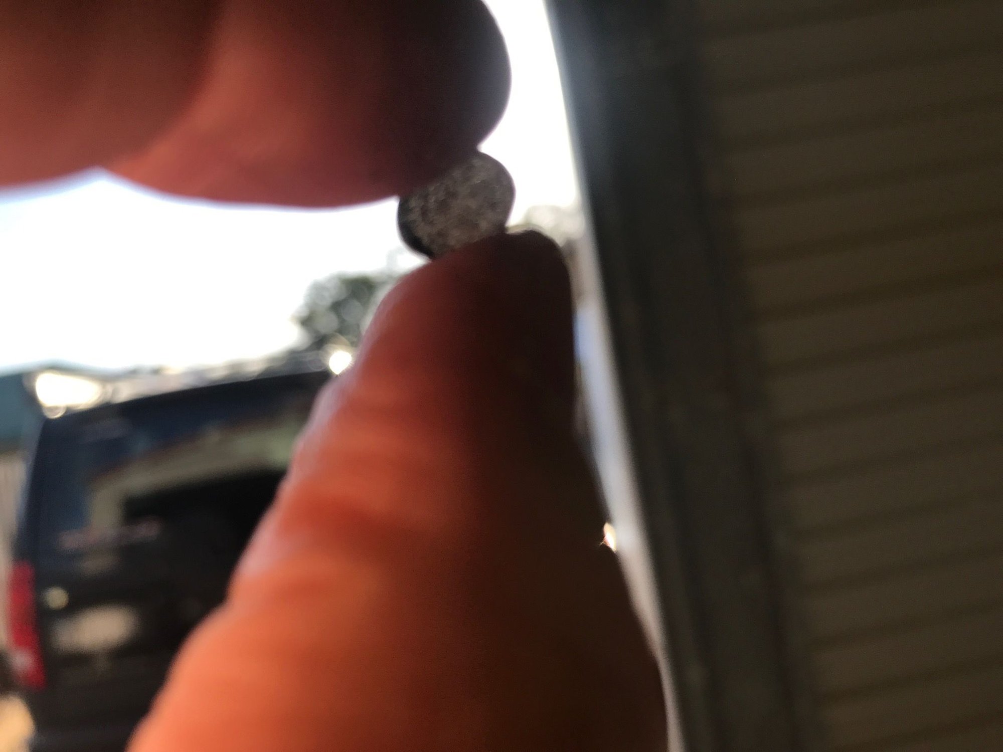

Hopefully somebody can provide a little guidance.
I have a failry new Evo 33GX gas engine in my little H9 RV-4 and to date it has been running quite well. I followed the break in procedure as per the manual as I had read these engine can be quirky.
Sunday I got one flight and engine was acting as though it was very lean. Landed, let cool and it will start and idel nicely but could not transition past 1/2 throttle, each time it would hesitate and die.
No amount of adjustment to needles changed this. We reset the needed to both being about 1-1/2 turns out but same problem persists.
Perhaps a blockage in the carby or even a crap batch of petrol?
I havent pulled the carby off yet.
thoughts?

Low ign. battery is a good idea, but if that checks out, I'd be suspicious of the little screen/crap trap in the carb being partially covered with that mysterious clear crud that just appears out of nowhere. That's where I would head next.

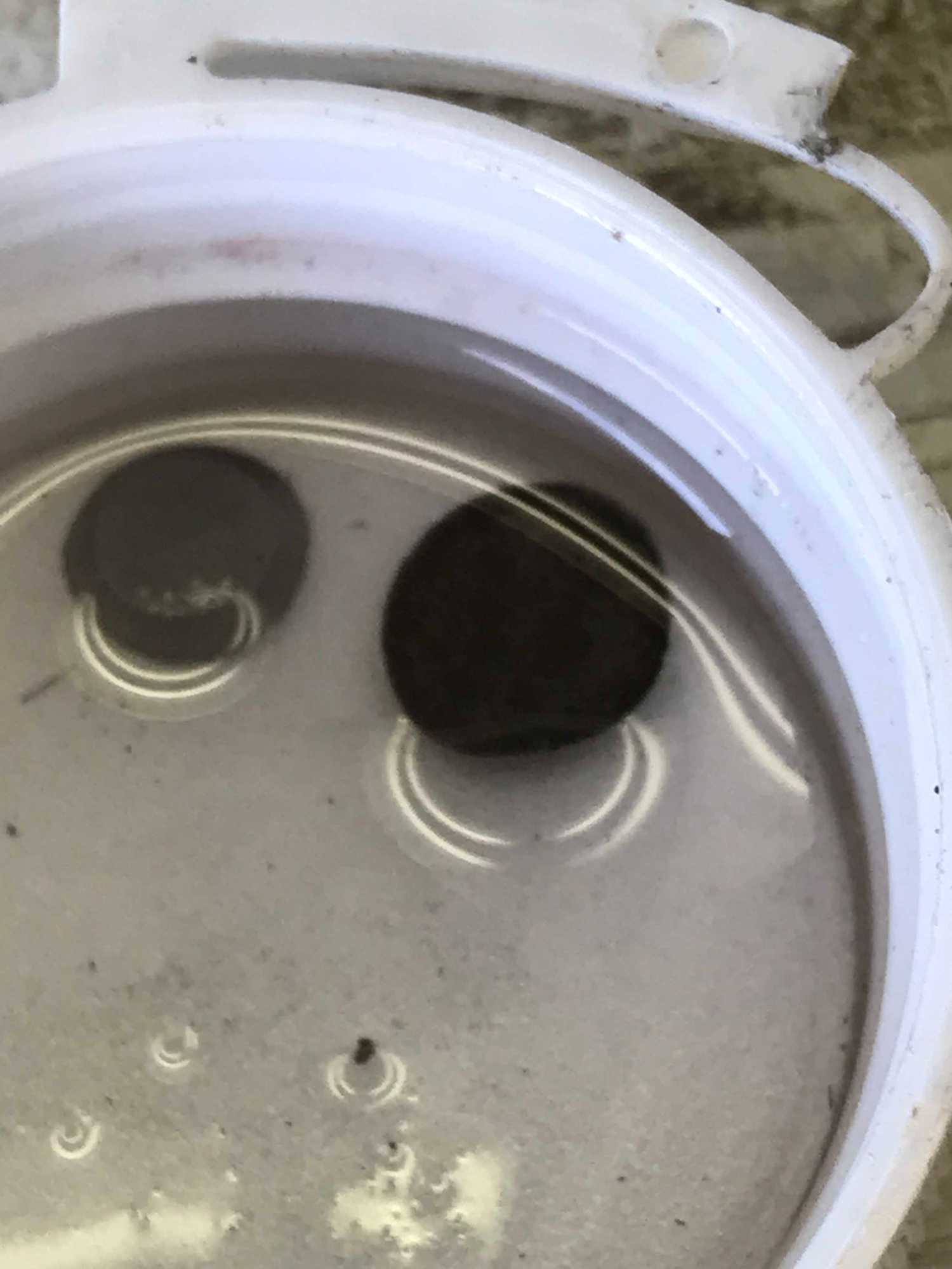

Not sure how a low battery pack would cause this. It had a fresh charge and the battery monitor I have in the cockpit showed full green.
I have an inline micro filter, that was quite clogged - see photo. the micro filter in the carby itself was very clogged. Quick soak in acetone and a clean with a small brush sorted them.
I'm quite convinced the last batch of 95 octane I used was dirty, I normally use 98 which lasts better and has less particles in solution.
the 95 will go in the lawn mower and I will mix up a new batch using 98 octane.
Will run it on Saturday and see.

Think I have found the cause of my blocked filters. I drained the fuel from my caddy into the can I have for mower fuel and looked into the bottom of the can to see loads of rust!! I use a metal 4L can that originally had Castrol M castor in it.
That can will go in the bin and now I'm looking for anew set up using a nylon fuel can and a new pump.
