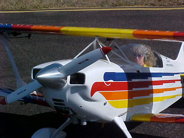

Texas 3D; Like the CE!!!! Mine is about to fly with the DA on it! Just need to tighten the flying wires and add some decals.
Dick, so which is the higher prop load at that rpm? the 22x10 or the 24x8? The 24x8 was recommended because it give you the best all around flight characteristics. You can do effective imac routines because of the thrust produced and yet have workable braking on downlines. You can also do effective 3D.
What are you using on your DA?
