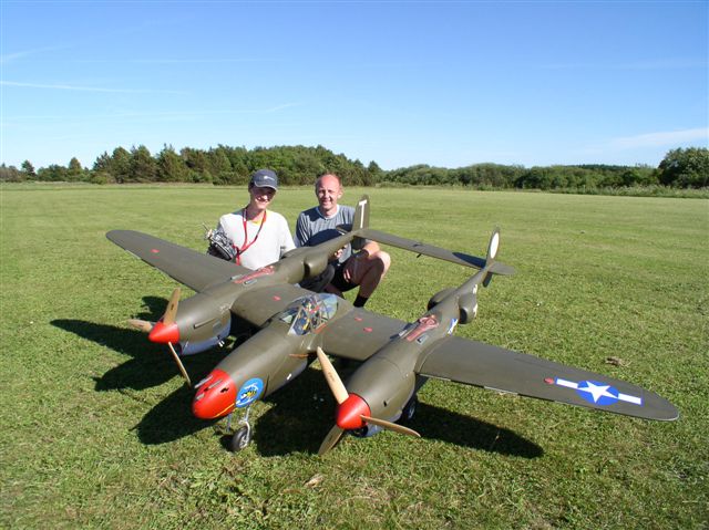

Got 2pcs DA50 in my Ziroli P38
13 flights until now gives about 2-3 gallons per engine and they are just running perfect. Am I to expect any problems?
Heres a picture attached me holding the TX and the builder behind plane.

Default RE: Does your DA50 do this?
I wouldnt expect any problems..I have 10 gallons thru mine and not a hiccup..

Beautiful P-38!!! [sm=thumbup.gif]
Best of luck with it.

Just listen for odd ticking noises at idle. If you have a bad rod it will give you warnings.

the engines say Click when i turn them but i havent noticed anything special when started.
