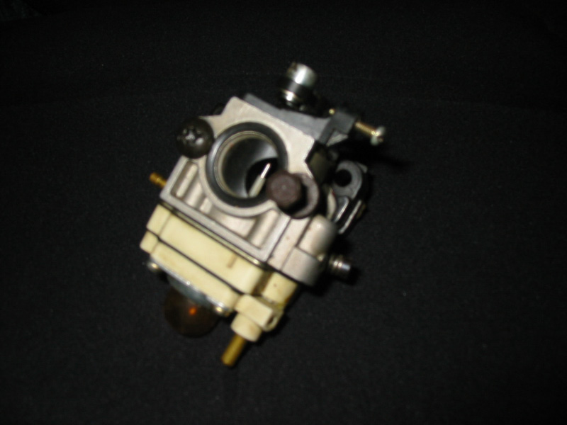

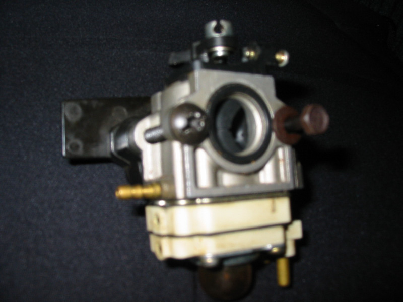

You can add the pulse line to carb on about any Gas 2 stroke engine. Then you do not have to contend with pulse holes that do not line up. Also like RCIGN says you can rotate carb to any position for better throttle push rod alignment...ect. Here is a photo of one done years ago for a carb that was on a Homelite engine. The nipple on the far left was added. Hope this works!!!
ID:	232074   Click image for larger version
