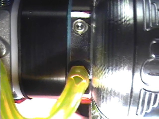

My Engine is 4 months old, how I know if my Engine has this modification?
Thanks.

if your engine has the carb modification there will be a fuel line from the carb to the reed block thats the black block between the carb and the crank case mine dose not have the update and it has this tube from the carb to the crankcase not the reed block here is a pic of a none updated carb. By the way only one flight on this and it seemed fine so far.
