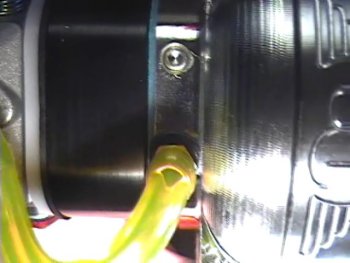

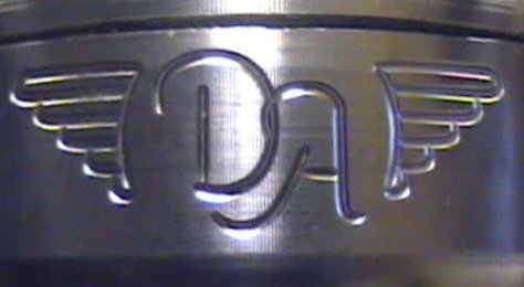

I took a pic of this I was told they moved a port in the case. I like the logo they did on the case as well

ORIGINAL: branded
I'm still not understanding the "fix" for the pooling problem. Can anyone give a better explanation?
And secondly, has DA volunteered to send anyone the new rod without sending the engine in fro replacement?
I have two of these engines I intend to install in a twin BF110 warbird.......
What new rod?
There not having problems with the rod. they are doing updates on the 50 by replacing the crank and bearing. because they have had some assembled that did not go thur the full harding process on the crank's.

The picture of the inside of the engine shows a copper plated con rod with the center opened up...The pulse port mod is something us engine converters have been doing for at least 18 years, putting the pulse directly into the carb backplate from a fitting in the case...The picture show the pulse fitting in the insulator block under the carb, not the crankcase...If the crank pin was not hard enough for the roller it's the same problem some converters had when putting a needle bearing on the rod in a ST3000...C&H did it for a while and quit when they found out about the soft pin....Right, TKG ?

It looks like they tapped a new hole and plugged the other one. Could that make a difference in fuel pooling?
Old 02-12-2005 | 10:14 PM
