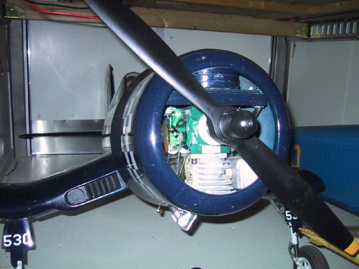

I have a Brison 5.8 in my Ziroli Corsair and love it. It has never failed me and vibration is reasonable for this size single. I am using an Abel muffler and it does a good job.

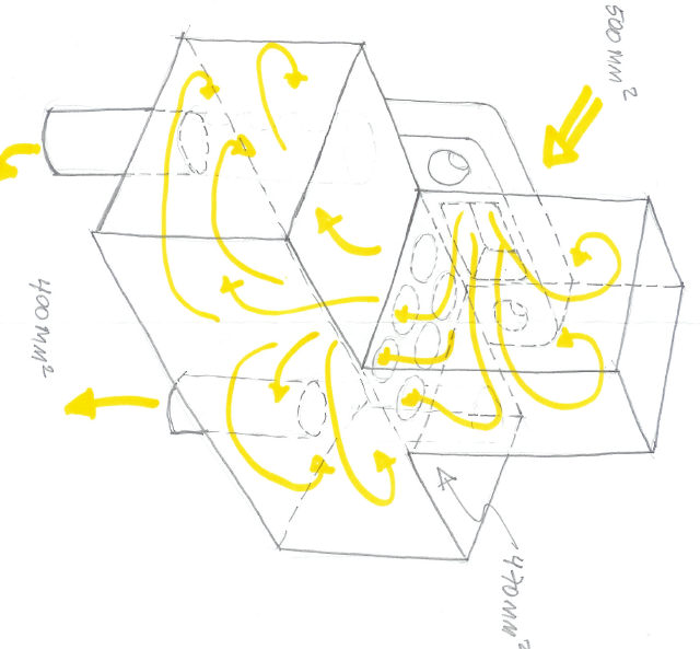

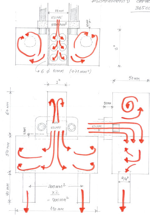

A few months ago my club created a noise cap of 94dB. My Brison was @ 102dB [X(], with stock muffler and 27x10 wood prop. Since we have more that 10 Brisons, and we live in Brazil (no easy UPS ordering), we created a new muffler. In my particular case, I got 93dB and, as a bonus 150rpm.
The execution costed less than US$ 30 per muffler.

Jerry, not trying to talk you out of using the six bolt hub on the 5.8 (would look pretty cool on the D7 though) but will give you my comments on the single bolt adapter. When my Brison 5.8 was brand new I bought a single bolt adapter from Gary at Brison. It mounted with 6 10x24 tapered flat head screws. Yes, they are small but very strong. I did remove two opposite screws and used two 10x24 socket cap screws with counter bored holes in the prop to keep the prop from turning on the hub. I have been flying my Corsair with this engine (see post #11 above) for over 3 years with zero problems. This has been an excellent engine and should be really good in the big D7.
