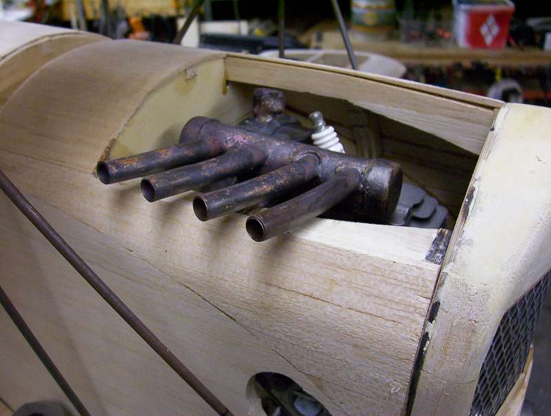

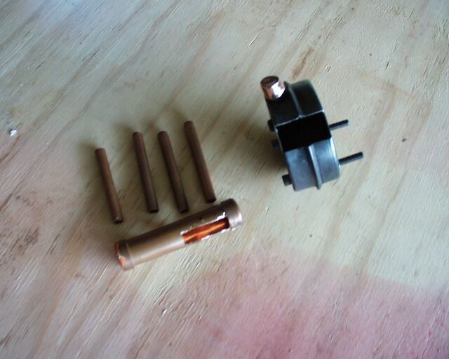

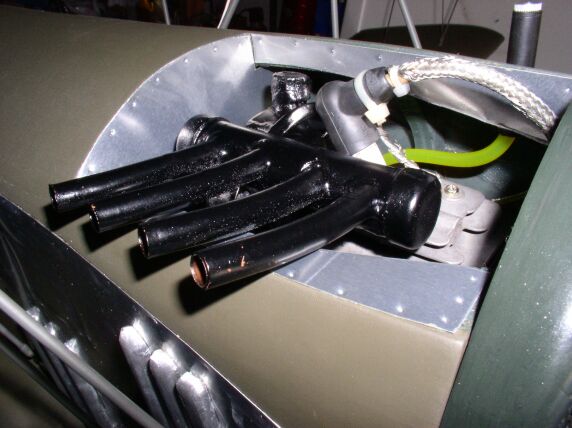

Old 09-13-2004 | 07:29 PM
Posts: 387
From: Cocoa, FL
Default RE: G38 - Muffler Modifications
Braizing is ok....
