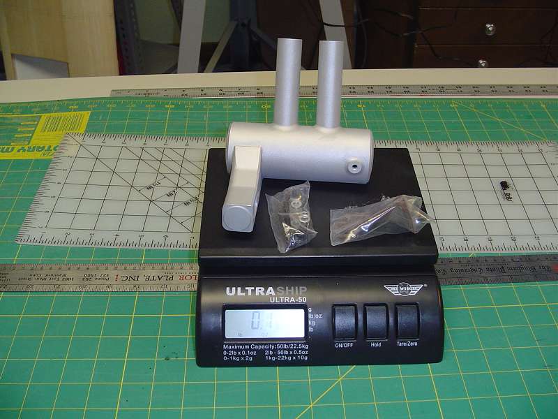

Absolutely not. Once your engine has five gallons of fuel though it you usual won't need to touch the needles again.
I know you found your muffler but heres another good Pitts muffler as well >

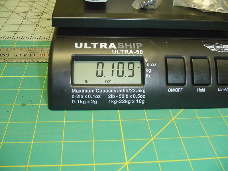

Doug,
I can't read the weight of that Pitts in the picture you posted.
Could you please clarify?

Here you go Shawn

Thanks Doug.
