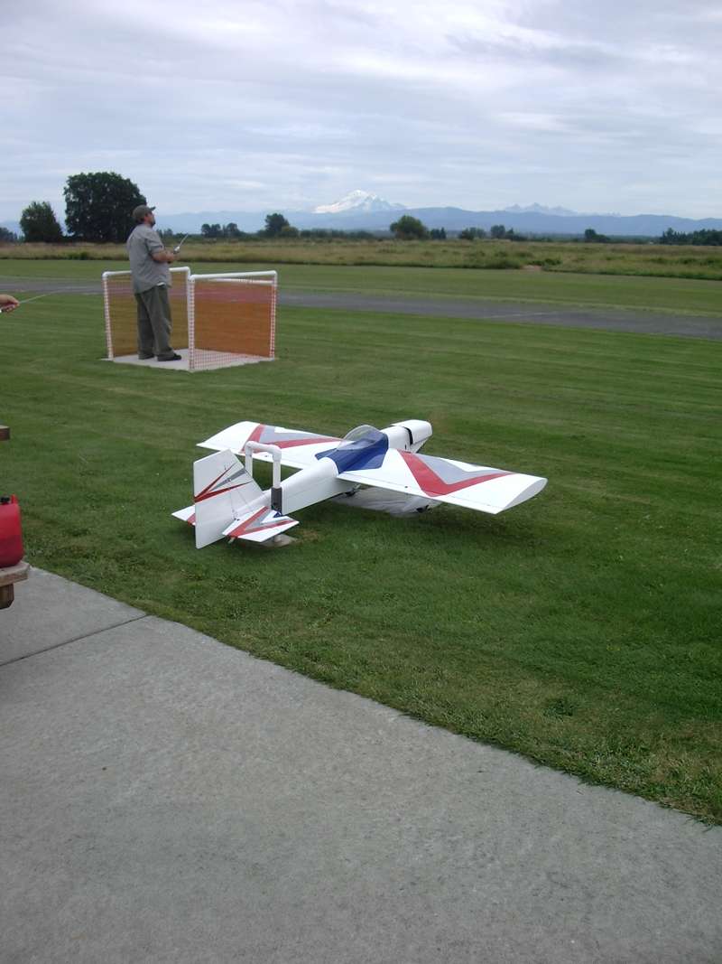

Old 06-22-2005 | 03:40 PM
mr.scale's Avatar
Joined: Jun 2004
Posts: 567
From: Harlingen, TX
Default RE: Stinger 120 question
Hi I changed the carb on my us 41 to a wa540, improve about 300rpms on a 20x10pro zinger,
peque!
