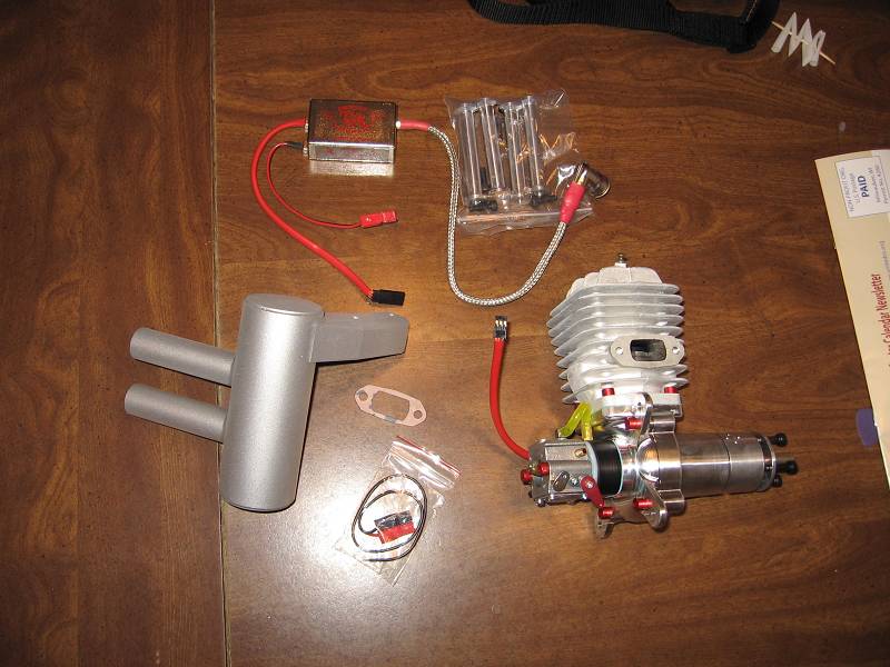

DA50
Engine bare with spark plug: 3 pounds exactly
Ignition: 3.7 ounces
3 inch stand off's: 3.3 ounces
8 bolts for stand off's: 1 ounce
Slimline pitts: 8.9 ounces
hardware for Slimline: 2 ounces
Total: 4 pounds, 2.9 ounces
Add a 4 ounce battery and a switch and you are at 4.5 pounds all up.

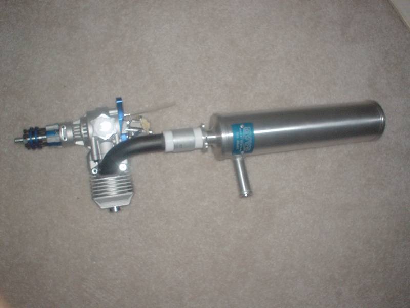

Evolution 58
Engine w/ spark plug 65 oz
Ignintion 5.5 oz
MVVS 3206 tuned canister w/ MMVS header & coupler 21 oz

Evolution 58
Ignition 5.5 oz
Albatross,
Are you sure about the MVVS canister weight?. It sounds a little high and David Moen of MVVS Canada posted a weight of 330 grams in another thread.

OK- 11.64 ounces - (330/28.349)

My experience (had the MVVS 45/canister/coupler/header) is that the HEADER and COUPLER are *really* REALLY heavy components in the total system. The canister may not be too bad (I personally thought it was a little beefy), but the other parts is where it really goes crazy, IMO.
However - performance sometimes costs "something"

I'll second that. I orginally had a the MVVS header for my 58 and KS can, and the header is quite heavy. I'm sorry but although I did weigh it at the time, I forget what it was. I kind of remember it was in the 6-7 ounce(or more) range with coupler...and it's only about 6" long. The KS stainless header I eventually made for the 45 is 11" long and weighs 4 oz.
This is off topic, but if you want a lighter solution than the MVVS header, KS(www.krumscheid-metallwaren.de) has several headers in different configurations that should come in at half what the MVVS one weighs.
The MVVS tuned canister for the MVVS 58 is a true anchor.
