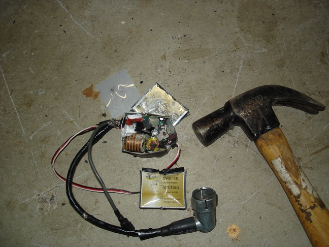

Torkwrenchmon
do you think we all Dumbos
i set the timming before i had started it
just in case you miss it this what i think of melody

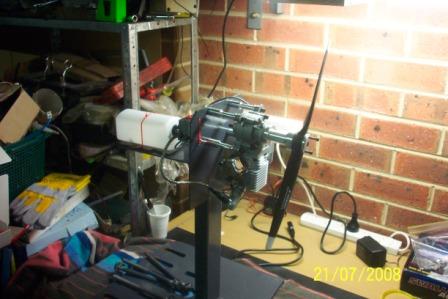

the only time run good was on the test stand i ran about 5 liters through it sorry 1 gallon
i set timing to about 28 btdc the battery is a 6 volt 3700 mah

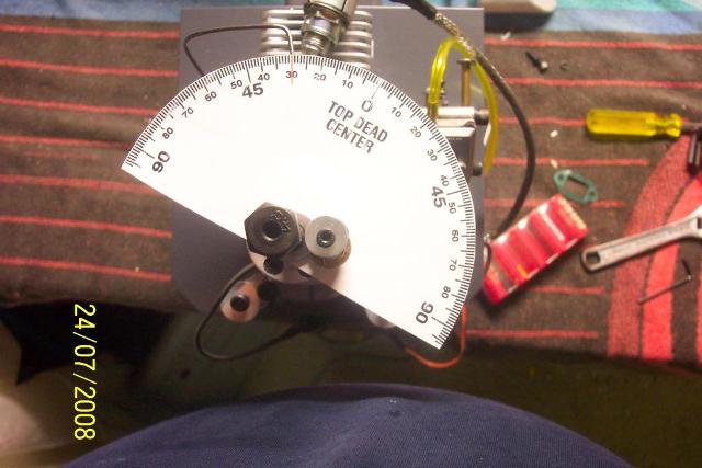

For Cermark rep. I have a tester that will show when the hall effect sensor detects the magnet. Buzzer and led come on at detection. I know how to determine TDC and time a motor. I prefer to use the detector rather than trying to hold the spark plug and see a spark.
Should the 30 degrees before TDC be set when the hall effect sensor first detects the magnet or
just after the magnet is no longer detected?

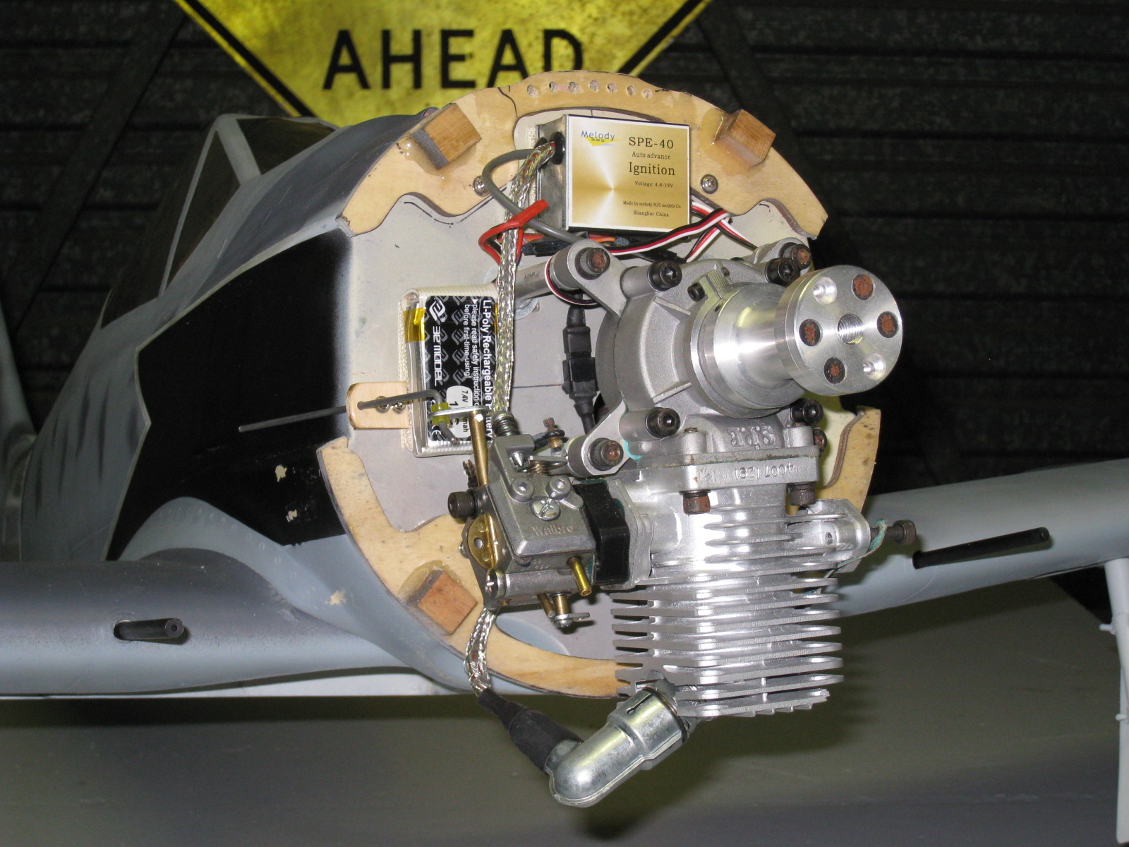

Hey Guy's
I have been flying my SPE 40cc for a while now and I have been quite happy with it using the stock Melody ingition unit. It provides plenty of power to get my 14Lbs Fw-190 around spinning a 18x8 3 blade prop at 6480rpm.
Anyways she has not flown for about 5-6 months after she was involved in a landing incident. I could be bothered fixing her[X(], but i have finally completed the repairs and fired the engine up today just to make sure it was all good. My SPE has always been a bit of a biter on start up, and today was no different. she also shakes the crap out of the model and the ailerons cop abuse because of it. On running her today i decided to take the cowl off and see if i could get it to run properly at WOT, because she has always misses or 4 strokes just a tiny bit.
Having stumbled on this thread again yesterday i read that all these symptoms are an indicator that the timing was out. So following all the links and instructions i found that mine too had been delivered with the timing set to about 50-55 degrees[X(]. So for those of you who have had the same attitude as mine of "if it aint broke, don't fix it" check you timing!!!
I'll run the engine up tomorrow after i fix the aileron hinges that have given up the ghost again because of the vibes and let everyone know of any improvements.

I got my question answered from http://www.cncengines.com/ where I bought the Hall Effect tester and timing setup. He recommends 28 BTDC. This is set just as the tester buzzer and light goes OFF.
After 2 gallons of Lawn Boy the rpm at full throttle seemed off. Checking the carb I saw that the carb insulator does not give a smooth transition to the engine. I am working on that and will post results with a 19x10 prop later. Can't use a 20x10 right now since I am breaking in the engine on a Giant Scale Big Stick.
No problems with the Melody ignition so far. BTW using an Ignition Battery Eliminator Circuit. So far no interference with the FASST receiver.

I haven't flown it since the re-timing, but i have run it. It started sooo much easier. RPM was down a little to 6350prm, Vibes were about the same[] I reblanaced the prop and spinner which were only slightly out so if the weather is good this weekend i'll see how she performs in flight.
Dave
