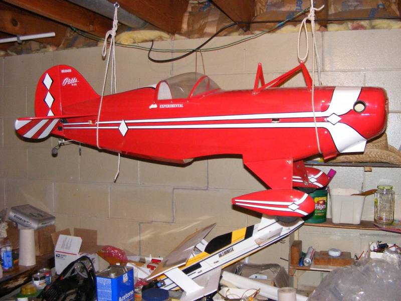

Default RE: SPE 40cc
I was planing on buying one of these SPE 43's to put in a 1/3 scale Great Planes Pitts I looked a long time for one of these pitts. Its discontinued so it wasnt easy. I feel this engine will fit in the cowelling without doing to much more cutting of the cowelling. The original owner of this plane had a 160 or 180 glow motor in it. I am a gas guy and i wont buy a large glow motor due to the cost of glow fuel and the amount of flying I like to do. If I understand all this info correctly the US dealer is Cermark? Are all the buggs worked out yet? God knows Ive had my share of buggy motors.

ORIGINAL: bluemagic98
the motor is fine if you don't wont to use it just to look at only

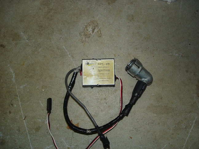

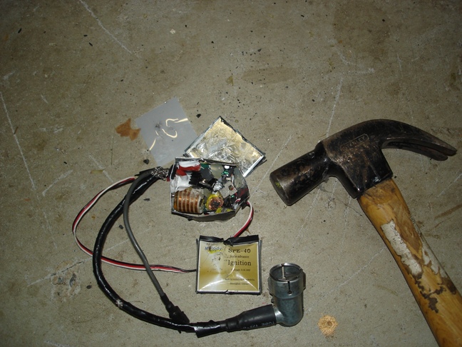

well fire up at work today well the beast is a live
what a peace of crap that spe melody module is
now it sounds runs like a real motor
be fore it max rpm was 6200 19x12 and it sound like a woman in labour
now max rpm was 8700 wow now it idles like a cat purring
Thanks Rcexl ignitions

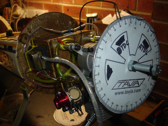

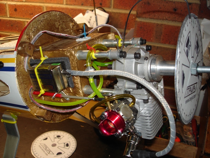

ID:	1132087   Click image for larger version
Old 02-10-2009 | 08:46 AM
  #294
ultra6a's Avatar
My Feedback: (27)
Joined: Sep 2004
Posts: 196
From: Charlotte, NC
ORIGINAL: crycroft
be fore it max rpm was 6200 19x12 and it sound like a woman in labor
Was the Rcexl ignition a direct bolt on? Did you have to set the timing on the engine?

Old 02-10-2009 | 08:59 AM
  #295
crycroft's Avatar
Joined: Mar 2007
Posts: 181
From: Melbourne, AUSTRALIA
had to set the timing with the new pickup
