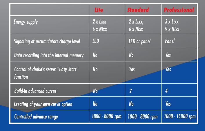

These are the new ignitions from mvvs catalog 2006. They already exist and they are out in the market .
just received some yesterday,i cant wait to see them in action!!
ORIGINAL: splais
"Yes the Evolution Ignition does give some neat features such as the tach reading and highest rpm reading from the last flight but those will probably make their way to the MVVS as well."
J,
Could you expand on this a little. Sounds like a great feature and I can't find anything about it on Horizon's site.
J,
