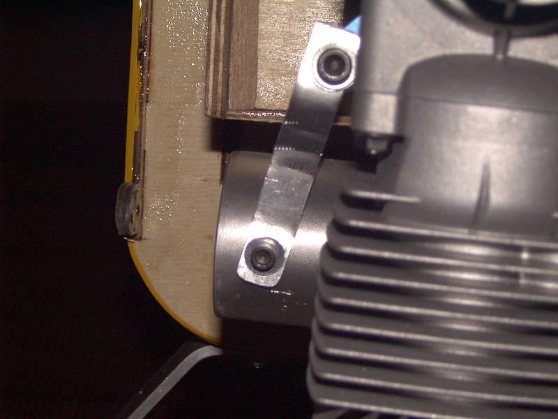

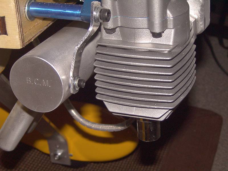

Old 12-16-2005 | 10:49 PM
ben beyer's Avatar
My Feedback: (23)
Posts: 2,385
From: Bryan TX
Default RE: Evolution 58 runs backwards
Is this braced adequately?

Old 12-16-2005 | 10:59 PM
Panzlflyer's Avatar
My Feedback: (15)
Posts: 1,960
From: Goldsboro, NC
Ben, it should be...they usually crack at the 90 degree between the round chamber and side mount. Never had that problem with a Supersonic or J&A
