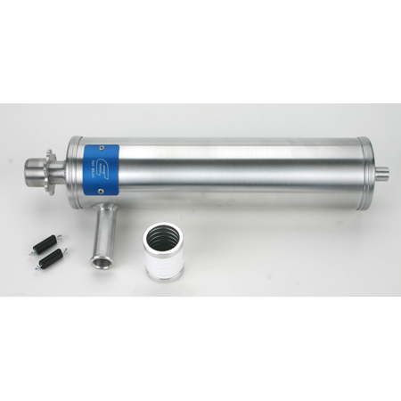

whats this from Horizon?

And this from an Mvvs dealer looks the same?

Well, there's a learning curve...
When the EVOs were introduced, the MVVS muffler was not available from Horizon...

hehe..sorry I noticed that the other day, Now I didnt say they have them yet and I havent asked them a technical question!
