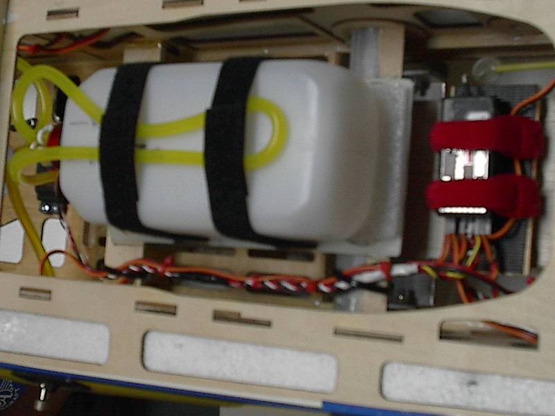

Old 01-15-2006 | 06:12 PM
My Feedback: (13)
Posts: 1,857
From: Chesterfield, MO
Default RE: What do you do with the tank vent?
I like to loop it on top of the tank all the way to the back end of the tank and then out the front, bottom of the cowl. This way, even with a full tank, I can tip the plane forward on its nose and no fuel will run out the overflow line.

Old 01-16-2006 | 11:50 AM
My Feedback: (28)
Joined: Sep 2003
Posts: 339
From: crandall , GA
heres a pic hope it helps.
I don't use a check valve, but I do use a filter. I also run the vent line to the top back of the tank then out the bottom front to create an "anti-siphon loop". Works well.
Also, I don't plug the vent line, especially if taking the plane from the 40 degree field into the 70 degree house... creates pressure in the tank and on the carb. Using the loop, I store the plane in the basment without any fume problems whatsoever.
