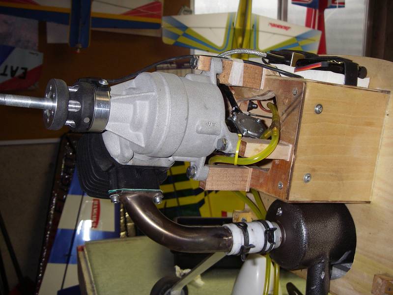

My best plane with "stupid power" was a 21lb H9 Edge and BME 110, it would go faster straight up than level lol. Torqued, you will like the 106 a ton, give it time to break in, ie 15 gallons or so, and you will see how it really runs.
The advantage of the new 80 engines -no one seems to really take notice of (wink wink nudge nudge)-is that for the price of the 110 --you can get a plane /muffled can AND the 80 -
at 21 lbs awful hard to fault the power at 22.25 lbs my 80 Edge is a runner even up here in the mountains
but if money is no object - go for the 106/110
I did -but am not flying that setup -I used the AMT pipe - and a 26x10 Mejzlic- runs in low 7000's
The big ol JMB can on the short header is so easy to do -quiet etc., and on the EDGE was a good match- depending on the type of flying -Iswitch from a 26x10 Skoerpa to a 26x12 ZM-this puts the engine in the very high 6000and low 7000 in th air -so at best power .
