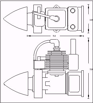

Can anyone give me information on the 3W-24 gas engine? I bought a SIG Rascal 110 from my LHS today and as a result of much research, it appears that this engine is about the only one that will fit on the Rascal's narrow firewall without the carb hanging too far out. I had originally planned to use the new Zenoah G-26 on it, but after checking the mounting specs, the carb will protrude almost entirely outside the cowl. This means that even the throttle linkage will be exposed. Looks like the 3W-24 will be just about a perfect fit. SIG has experimented with the new FPE 1.3 engine, but this engine does not produce as much HP as the 3W. I own an RCS 140 engine, but I have never gotten this engine to run well at all in the air. I have already lost one new airplane to this engine and do not want to lose another.
By the way, the firewall dimensions of the Rascal are 4.25 " wide by 7" high (rounded at the top).

another option is to look at the MVVS 1.60 gasser (26cc). The carb is in the front and will sure fit your dimensions with plenty of space to spare.
Will turn 18" props in the 7000+ rpm range depending on mufflers used.

I don't know what information you want on the 3W-24. The measurements can be found on the Aircraft International web page. As for performance, this engine is the most powerful 22-24 cc engine in the class. It has the same power as a G-38 while weighting about 50% less. The preferred prop is a 18 x 10 which this engine turns in the low 7K rpms. It will turn an 18 x 8 at 8K rpms. By comparision, the RCS 140 turns a 18 x 8 in the low 7K rpms and the G-23 is weaker yet.

I just took an eyeball measurement on my 3W24. It looks like the header extends about 2.5" out from the centerline, and the can at the rear extends out further.

I have a Rascal 110 and also have a 3w-24 that I am planning on putting on it.
I am using JR 4721 servos on everything because thats what I had in the shop.
The thing that concerns me most is what muffler to use. The pits muffler that I have is wider than the cowl.
Does anyone have any ideas as to what muffle I could use that fits within the cowl width?

I think it is a supersonic. I will have to measure the width as I do not know how wide it is. I only know it will stick out of both side of the cowl if I use it.

What's the width of firewall? Maybe a better question is, what's the width of the cowl where the muffler is hitting.
Had my dad measure the width of the muffler at the widest point. He says it's 5 1/8".

The manual calls for 60 ounce servos on ailerons, rudder, and elevator. The 4721's are overkill, but it beats buying servos when you don't need to.
The firewall is around 4 5/8" wide and the cowl is the same width.
If your muffler is 5 1/8 wide, you got 1/2" sticking out the side of the cowl, and if its the same as mine, it won't be just one side. It will be centered up so that there is about a 1/4" sticking out each side.
I am thinking about getting a small header to put on the engine and some flex pipe to run out the bottom of the cowl.

My friend has the Rascal 110 and I have a 3W24.We took measurements and this motor is just a little too wide for the firewall.I'm sure it would fly it great,but it would stick out the sides of the cowl a hair.He decided to go a different route.

How about one of the new two-ring Ryobi conversions?
31cc
VERY narrow, not too long....
Just a thought!
Dimensions/Pics here...
