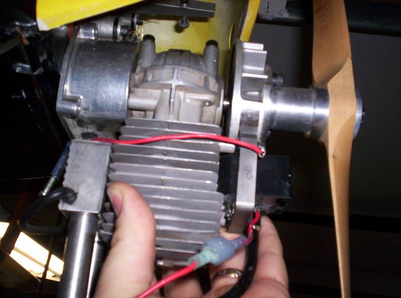

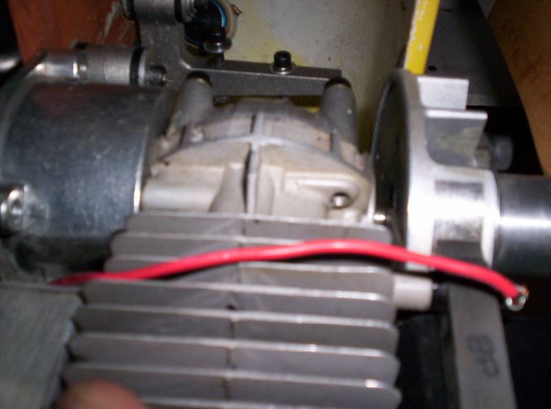

Old 04-23-2006 | 07:54 AM
mrbigg's Avatar
My Feedback: (21)
Joined: Oct 2004
Posts: 4,832
From: Streator, IL
Default RE: G38 engine mount
By looking at the prop hub, I was thinking it was aftermarket. I put it up to the plane to show you my problem. Hard to see, but the cup mount is against the firewall.
Edit: Hey, Ralph look at the last pic. Your conversions go in the cup mount right? That would mean the flywheel and coil would be removed and it might work. As for right now, removing the cup mount alone doesn't do me any good because the muffler is in the rear.[:@] The prop would still be sticking out pretty far also, unless you could do something with it.

Old 04-23-2006 | 11:49 AM
Antique's Avatar
Posts: 9,825
From: Somewhere, DC
Ignitions are in the mount, the magneto coil and flywheel are taken off, the hub can be shortened quite a bit and the carb rotated...$175
Old 04-23-2006 | 01:49 PM
mrbigg's Avatar
My Feedback: (21)
Joined: Oct 2004
Posts: 4,832
From: Streator, IL
Sounds good. Let me save up the cash and we'll get it done. (married with children ya know)
How close can you get the prop with the flywheel and mag removed?
Old 04-23-2006 | 01:53 PM
Antique's Avatar
Posts: 9,825
From: Somewhere, DC
1/2 inch from the end of the crankshaft...
