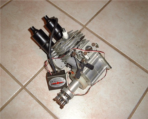

I got this engine on a trade. I hope someone can tell me what this engine is. The owner had no use for it and really I don't either. I am into much smaller planes and engines. Thanks for your help.
The only thing on the cylinder is:
MAHLE
44ZN 18
CARBURATOR: WALBRO

looks like a sachs 44cc I will buy it if you dont need it,does it have the ignition and how much?

How about a Sachs 3.2. Looks like an A&M. You have the ignition, but the engine is missing the timing ring on the front.

It's an old A&M Sachs 3.2..The ignition sensor is missing from under the hub...Take the single bolt adapter off the hub and look at the crankshaft...If it's smooth on the end it's not a Sachs crank...Some worked well, some not so well...A Sachs crank is a direct replacement..(But $$$$) .....
Hello, TKG..
A&M was the only manufacturer to paint the top of the cylinder....
