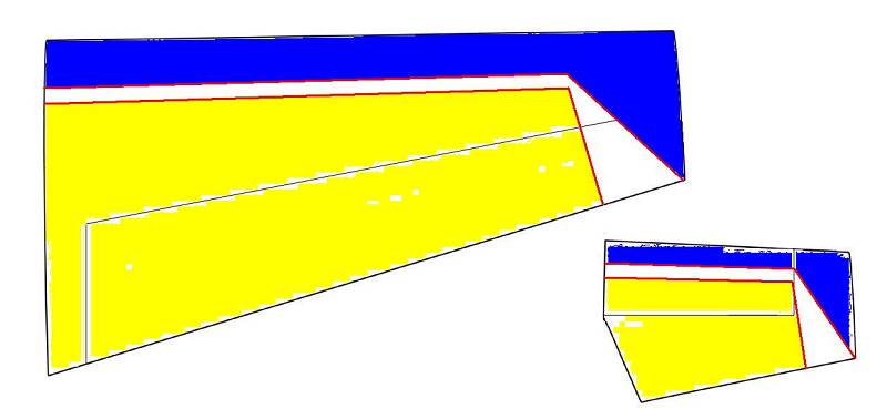

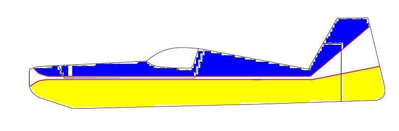

ended up putting my AW extra up for a while, but plan to put a 3W 157 in it as long as they stay $1450. Now working on my PBG 42% Extra 260, same plane Frazer flies, and I already have a 3W 200 cs-ts for it on 3W cans. Does anyone have some experience with prop choice? AUW is 43-44lbs, i know the engine rips the new 3W 32-14 3D, but what about 3 blades?
Thanks, Matt
here is a preview of the scheme i'm painting on it...
