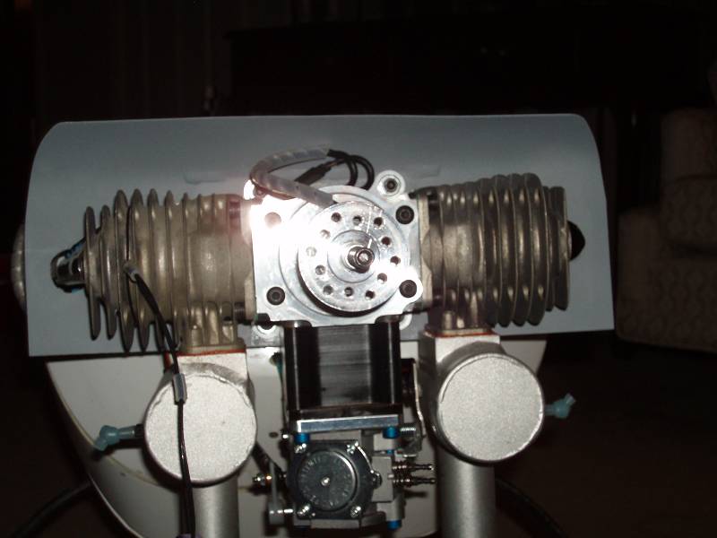

Here is a quick attempt at improving the minimal baffling I had. It will "some what" form a seal on the top and sides of the cowl. This little extra baffling that I am adding only took me a few minutes of actual time.
I will report back on temperature differences once I get a chance to take some. The temp gauge I am using it the one Geistware used in his experiments.

Jeff- With the new carburation it is more user friendly when setting the needles. The engine also seems to run a Little cooler, but I have not run the 115 in 100 degree weather yet either.
I will have some numbers on temps in the next week or so, but I can tell you, baffle all your engines no matter who makes them. The drop that Geistware and Albatross have seen will make a BIG difference in the power the engine puts out and I like lots of power! Some times I fly pretty hard and really push the engine. I can tell when the motor is starting to get a little too warm.

I went flying yesterday and have some numbers to report. The extra baffling in my above post knocked about 30 degrees off of my max temp. I ran the motor really hard, a lot of race circuit WOT and extended flat spins at WOT. I have the sensor at the back of the cylinder which reads about 30 degrees higher from the front according to my readings. My next attempt will be to make more air flow through the back cylinder fins and not escape around them.
Silversurfer-wait to you see what baffling I have planned for the Suk
Happy New Year.

Jon- If you have decent baffling, adequate exit area, a low pressure lip on the exit area, and a well tuned engine. I would say you could torque roll all day
Todd Blose has a video on the BME web site of a 3 minute hover, and I believe he did not have any baffling at all. Granted it looked to be a cool weather day by the clothes he was wearing, but if you don't cook it in 3 minutes you never will.
Now if I could just hover for one minute I would be happy[]
